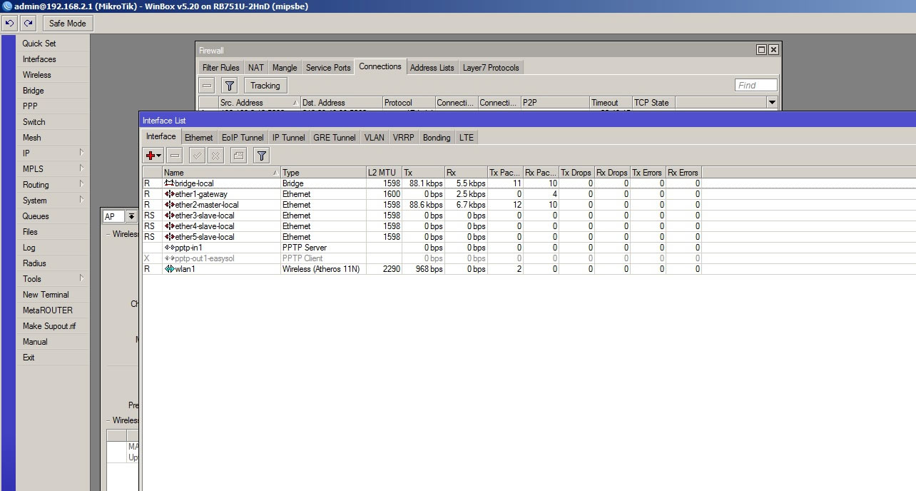

Funny thing is, somehow it shows me only 2 active interfaces with data flow(except wlan), while I have all 5 of them connected, 1st is ISP (goes to bridged modem) other 4 are local, 2 is voip phone, 3 is ip tv, 4 is another wifi router (because somehow my sony vaio leptop is unable to connect to mikrotik wifi ) and 5 is connected to my pc. So I dont see the logic, in the winbox on interfaces it shows me 3 active interfaces, one is bride, other two are gateway and master local, is this normal ? why other interfaces are showing 0 ?
enslaved ports only show up under the master. Since you are setup that way you can’t do it by port since you have them all on the same L2 switch. You will need to specify the devices by IP address.

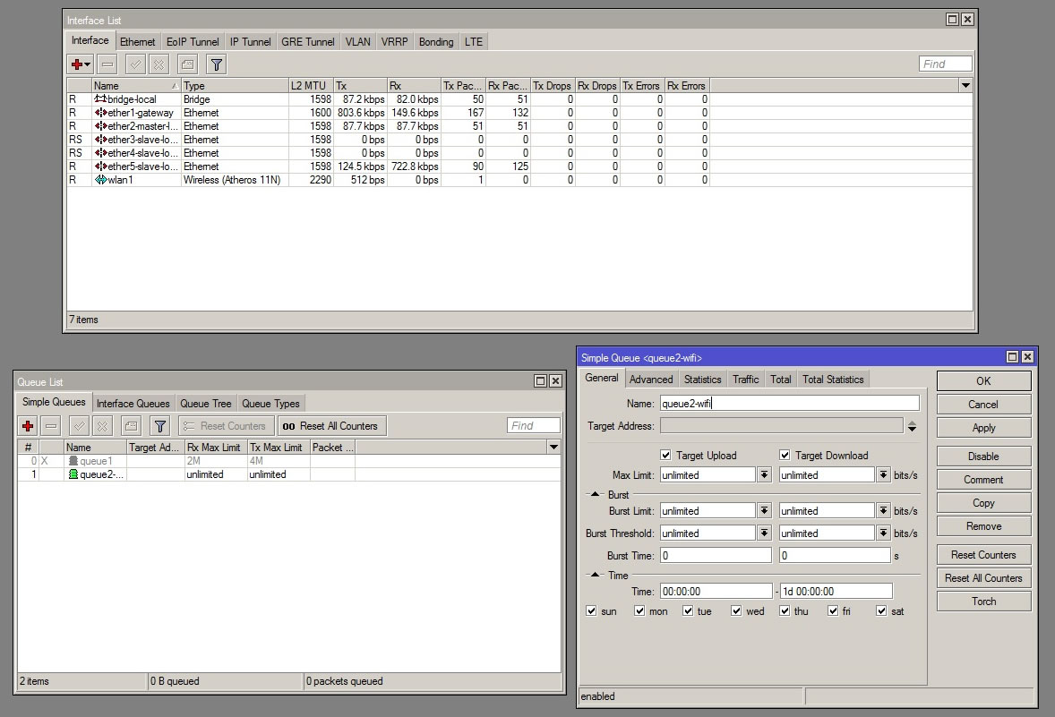

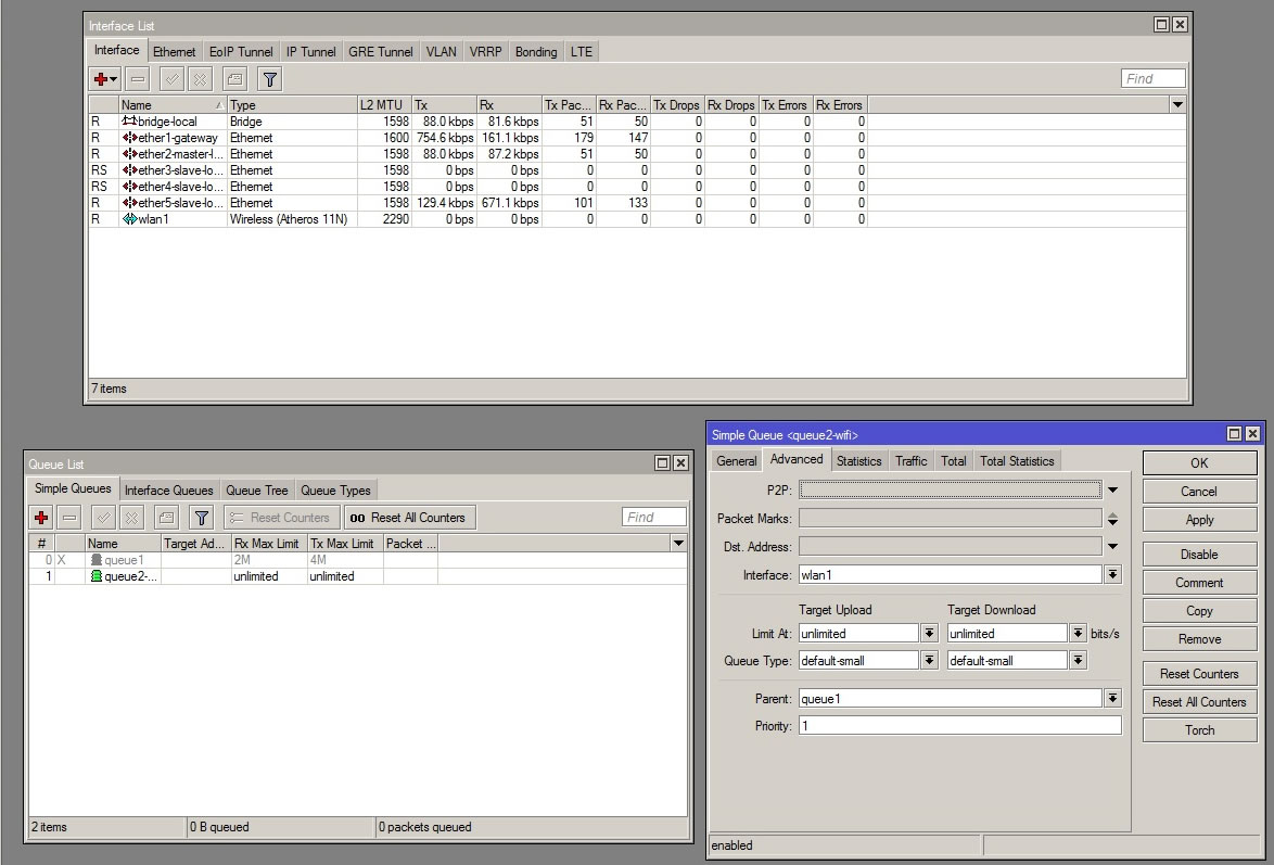

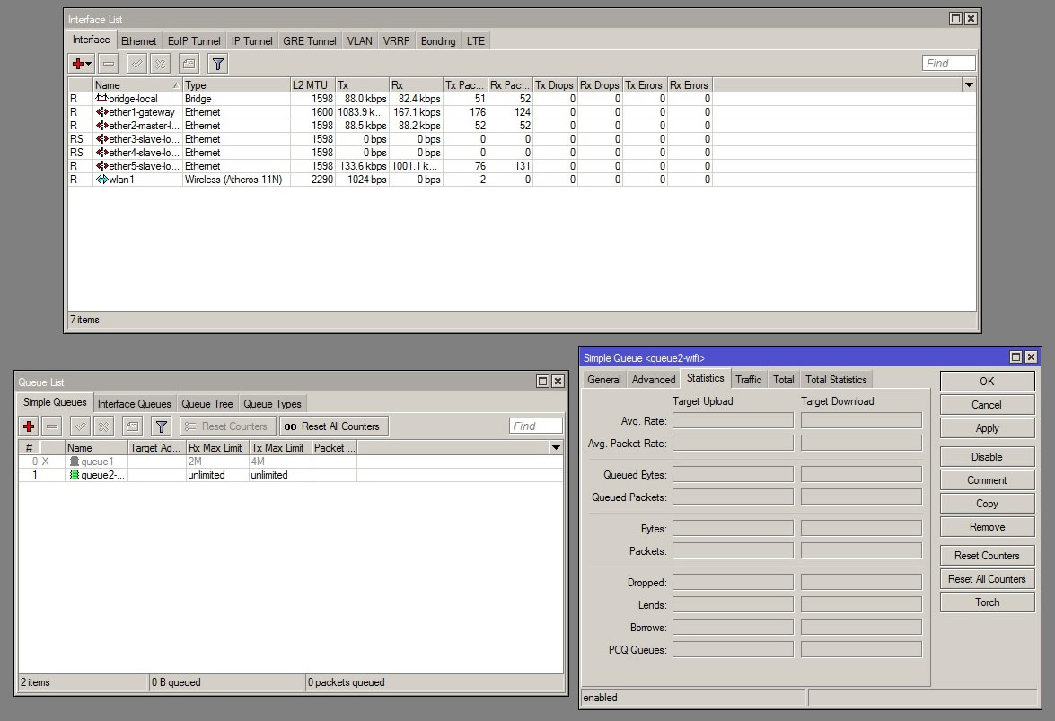

I did, but somehow I dont see any activity on the statistics and also I dont see any change on my wifi device, so from the start I could get 8.42mbps, and after adding this que and even putting limit of 2mb or 1mb it’s not limiting it. so it’s like it does not see the wifi interface, while it’s properly selected.
hereby some screen shots :

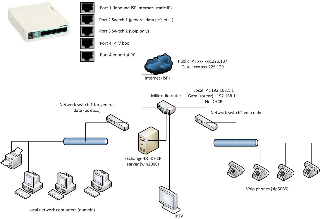

now I have installed same router in our office, now the problem is I cannot change the port from slave to normal, as soon I do that the port becames unusable, I’m unable to do anything with it, even setting a separate dhcp on that port does not help.
In office I have a diferent setup, my ISP is set by static IP, and Local net is without DHCP on the router, DHCP is installed on win server DC exchnage. So by default DHCP of the router id disabled.
Now after basic setup I get the router to work, but then all on same network, so I’m unable to separate the ports. I will add a full diagram of my network in office sothat it’s easy to see what I mean.
I need to separate all ports, and make sure that they get connected, some ports without DHCP, other with dhcp from router. and at home it does work, but not in office. please advice if possible.
I need to do this to completely and easyly preserve bandwidth for important pc’s and voip phones, and all others general data is not important so they will have not reserved connections.
