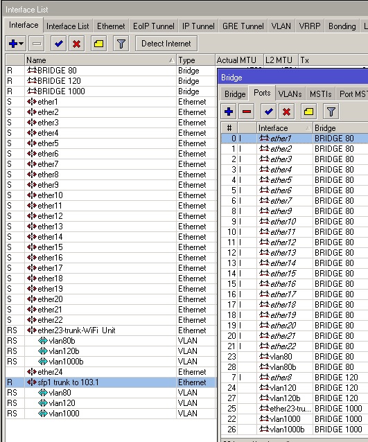

As you can see below(A sample of 2 of my units). I bond each physical ether interface to a bridge, and the bridge forwards appropriate traffic.
Also each bridge can have firewall(filter) enabled, so I’m sure I can filter appropriately using the bridge-filter(firewall) function.
