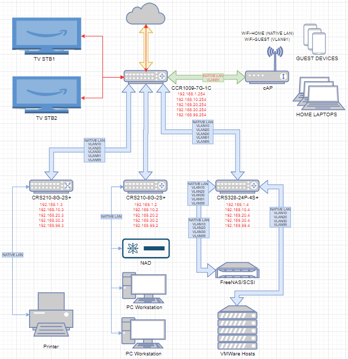

What I was actually interested in was the other part of my post - whether the PC to NAS traffic is bridged via the CCR (or possibly even routed through it if the PC gets its IP from a DHCP server) or whether it can bypass it when the PC and the NAS are connected to different CRS.
@anav’s remark is also very relevant - it is not a good idea to attach both the tagged end of the /interface vlan and its untagged end to the same bridge. So just remove that red line from /interface bridge port, it won’t break anything. You don’t need to do anything special to permit VLAN 99 as tagged on all the member ports of the bridge-LAN except listing those ports in the tagged list on the row with vlan-ids=99 in /interface bridge vlan.
Consider CCR is Default router and filtering FW.
Diagram is attached.
If the PC and the NAS discussed above are normally in different IP subnets, it means that the traffic between them must run through the CCR in order to be routed. If the two devices are normally in the same IP subnet, you could connect the switches to each other directly (and only one of them to the CCR), so that you wouldn’t waste the CCR’s CPU power on bridging.
And you still haven’t answered what does /tool profile show at the CCR when you test the transfer between the PC and the NAS, nor whether the only change between “all good” to “all slow” was the RouterOS upgrade on the CCR.
Thanks for reminding me Sandy.
I had checked this before. Yes they are in the same IP subnet.
Also I have defines specific routes which to avoid passing this traffic to CCR - it goes only via certain interface if is from the proper address.
