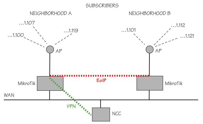

I have two MikroTik routers in different physical locations, with different public IPs. I want to distribute a single LAN IP address range between them (e.g., 192.168.1.0/24) such that LAN devices on either router will be able to see all the other devices on the same LAN, regardless of which router they are connected to. Each LAN device will use its local router’s address (192.168.1.1 or 192.168.1.2) as the gateway to the greater internet, to avoid swamping the inter-router link with needless traffic. The inter-router traffic between LAN devices will in fact be very low volume, it just has to work.
I followed all the directions in http://www.mikrotik.com/testdocs/ros/2.9/interface/eoip.php under “EOIP Application Example” to set up a LAN VPN over EOIP, including bridging the EOIP tunnel with the LAN interfaces. The PPTP link works fine, but the EOIP tunnel doesn’t seem to do anything. From either router I can successfully ping the gateway address of the other router (which I believe is a PPTP function), but I can’t ping any LAN devices on the other router.

What do you have in /interface bridge export?
After a long time reviewing the configuration, I found the problem: /ip address had been applied to the interface alone, and not to the bridge. When I fixed that error, the tunnel worked, and I could ping any LAN device successfully from either router.
