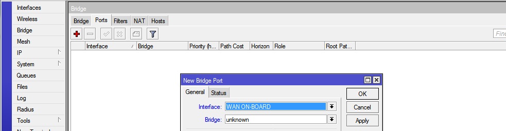

configure AP1 as
add bridge in tnterface as bridge1
wireless mode=AP/Bridge with Wds-mode= dynamic & Wds-default-bridge=Bridge1
ip add on ether /wlan
add ether in bridge port with bridge1 & also wlan in bridge port
snap is attached
you can repeate the same configuration in ap2
