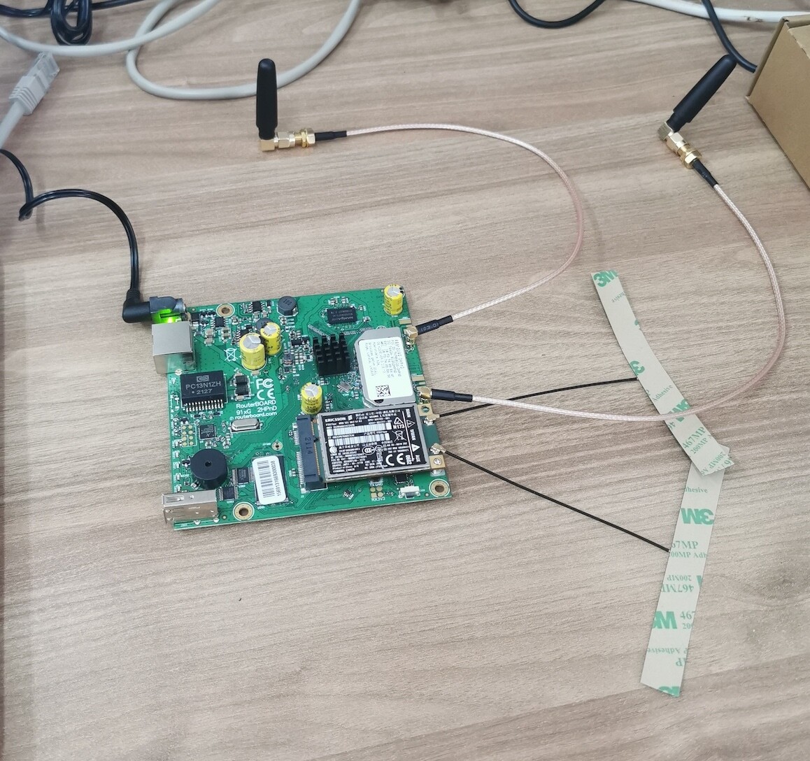

Laptop next to RB912UAG has -50dBm WiFI signal strength. Why?
I’m not experienced in radio/antenna/wireless physics. Could somebody please take a look at the attached photo of my RB912UAG setup and tell me if I do something wrong (my guess is WiFi antennas in dumb positions?).

The issue is that IMHO the WiFi signal is very week. The laptop standing right next to it has -40-50 dBm signal strength displayed on the registration table:

Internal LtAP Wi-Fi antenna is solded. Remember that each connector you your cable have attenuation on your signal strength.
Regards.
I’m aware of that. Unfortunatelly there is no other way with external antennas than through connectors. At least MMCX is one and SMA on the other end of the cable is another. Connectors make the signal strength weaker but the antenna itself should be much stronger. Right? Otherwise using external antennas would make no sense
A 2 dBi antenna is not strong at all. It is just a little bit stronger than the simplest short di-pole (which is at 1.5dBi). Difficult to have less gain.
-50dBm … is 70dB loss … due to the receive antenna coverage of only a very small part of the surface of the sphere representing the omnidirectional (+20dBm) transmitted power.
Very close to the antenna (eg smartphone standing against the hAP ac2 housing), can give -10dBm received signal. (This is 20dBm too much for good reception, -35dBm is considered the max allowed for received signal, -86dBm is mostly the minimum). Signal drops 6dB with each doubling of the distance (in free field condition).
There’s surprisingly large number of antennae types out there with gain lower than 0 dBi … mostly they’re multi-band antennae and most of them are shitty only at lower part of “covered” frequency band, but vast majority of specs hide this “minor detail” … which can make life of some users really miserable.
But as mentioned: even with perfect antennae higher gain comes with a price: non-spherical gain diagram. Which means better performance in certain direction(s) and (much) worse performance in all other directions.
