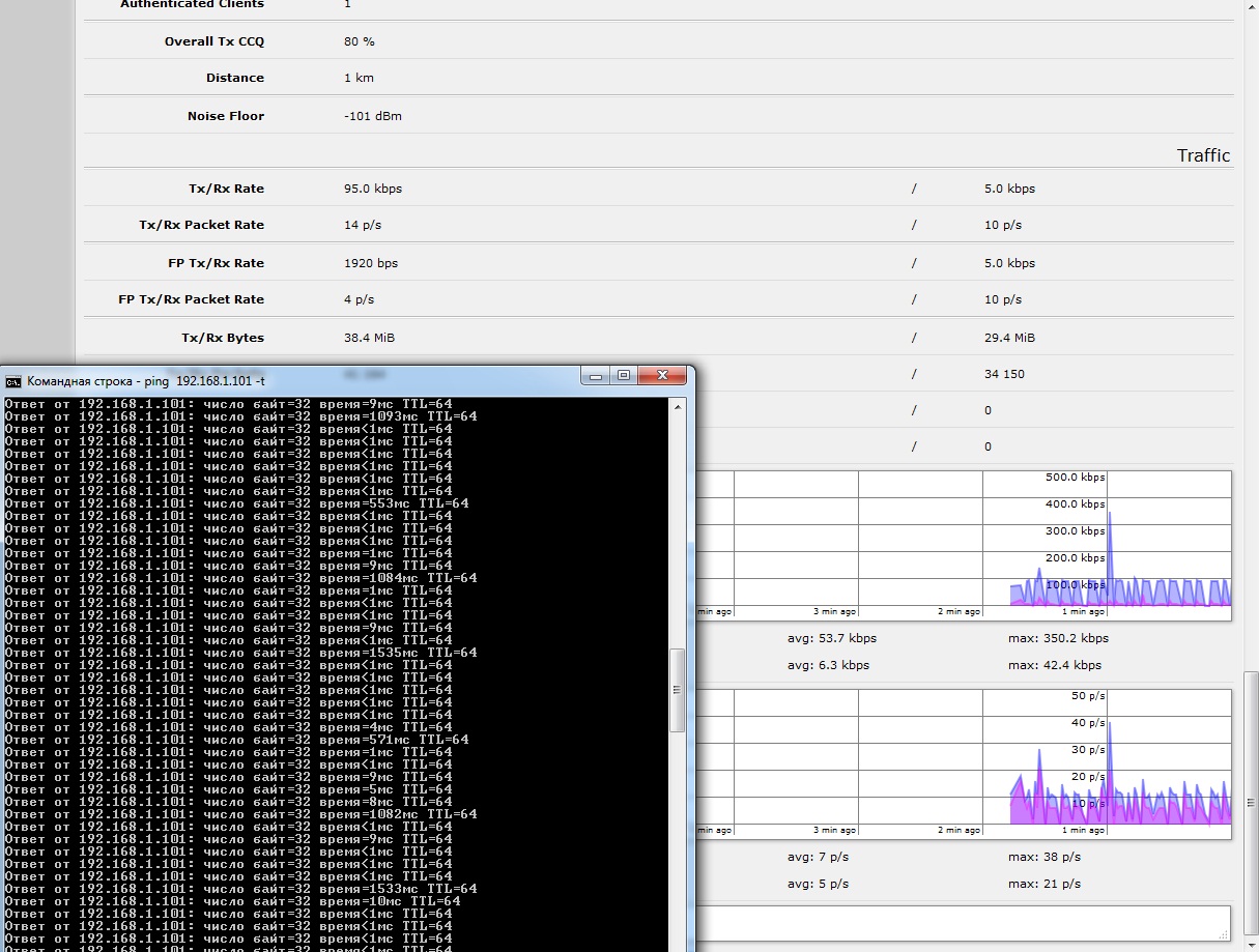

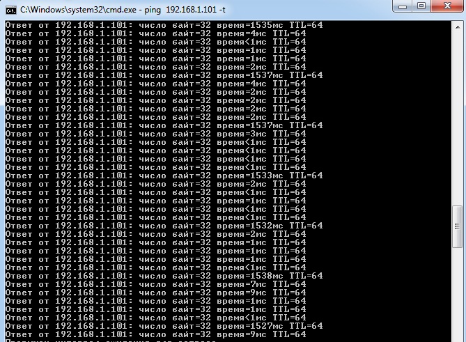

Hello! Help, please! There RouterBoard433 it has 2 cards. One of them works as a bridge and connected to another sector directional antenna for 5 GHz. The second card works on 2.4 GHz B/G and distributes adopted across the bridge online around itself by means of an omnidirectional antenna. The signal bridge good, the speed is 36 Mbit. if you connect to point over ethernet, everything works perfectly. If you connect to it via Wi-Fi from any device - Toi Internet is quite slow. Began to look for the cause seems to be found. Every sixth packet of the ping is delayed 1530 milliseconds! And this I pingou very point. The distance from the device to a point not more than 15-25 meters. The power of the transmitter is by default. The signal from the device in radius of 10 meters -79/-79. Help, what to do?

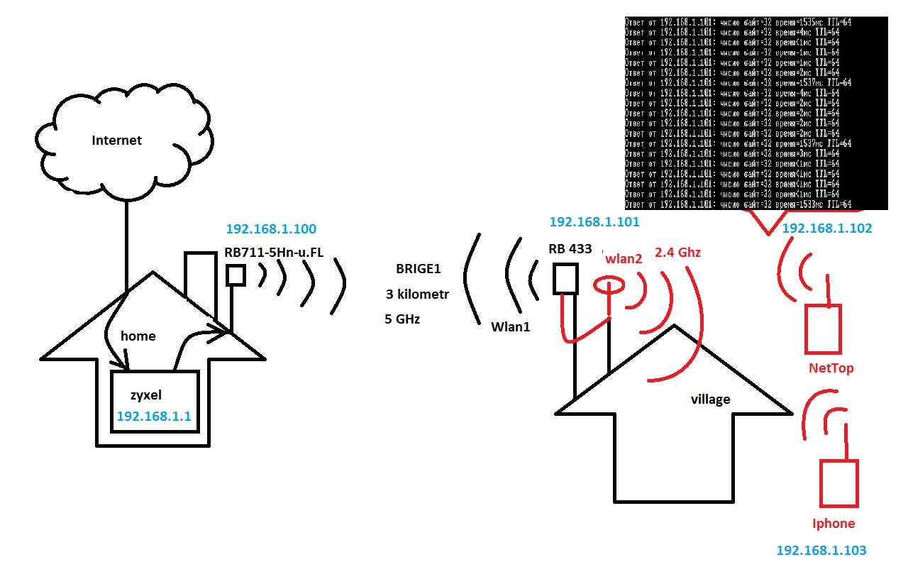

I drew a scheme

Yesterday was in the village, here is a screenshot from the computer.

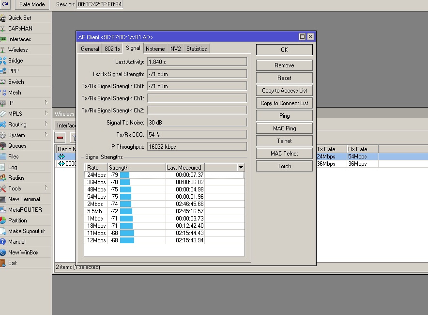

CCQ varies from 64% to 94%, although the computer and the access point is installed stationary and is not moved. The distance between them is 5 meters.

registration tabl in Attachments
CCQ is too high. Try to reduce power (point on Poland as a region, if you are using external antennas put the dBi in the appropriate field too).
