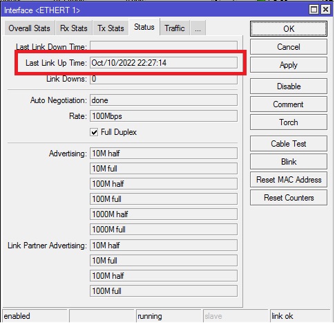

Guys,
How do I get the “LAST LINK UP TIME”?
EL DONCITO.
Where do you want to get it?! You see it on interface…
That would I also like to know.
You can see it in Winbox, but not on command line:

Other has asked for the same before
http://forum.mikrotik.com/t/how-to-see-ethernet-port-uptime/67669/1
Really?
:put [/interface get ether1 last-link-up-time]
My head was not at the right place.
As always short and quick solution by rextended :slight_smile:
