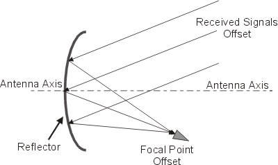

a 60cm dish should give you better signal than an SXT ac. Make sure to adjust the antenna properly, since this is an offset mount, the beam points upward, basically you would have to tilt the dish downward, to make sure the beam goes straight

normis: great tip! so you mean offsetting the whole dish instead of playing with the mounting arm (dish mounting hardware allowing)?

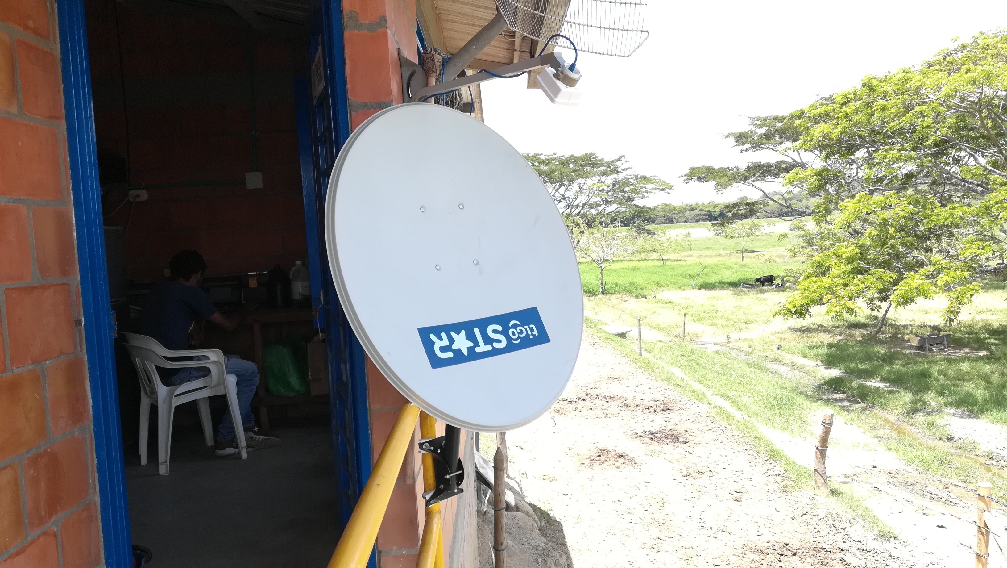

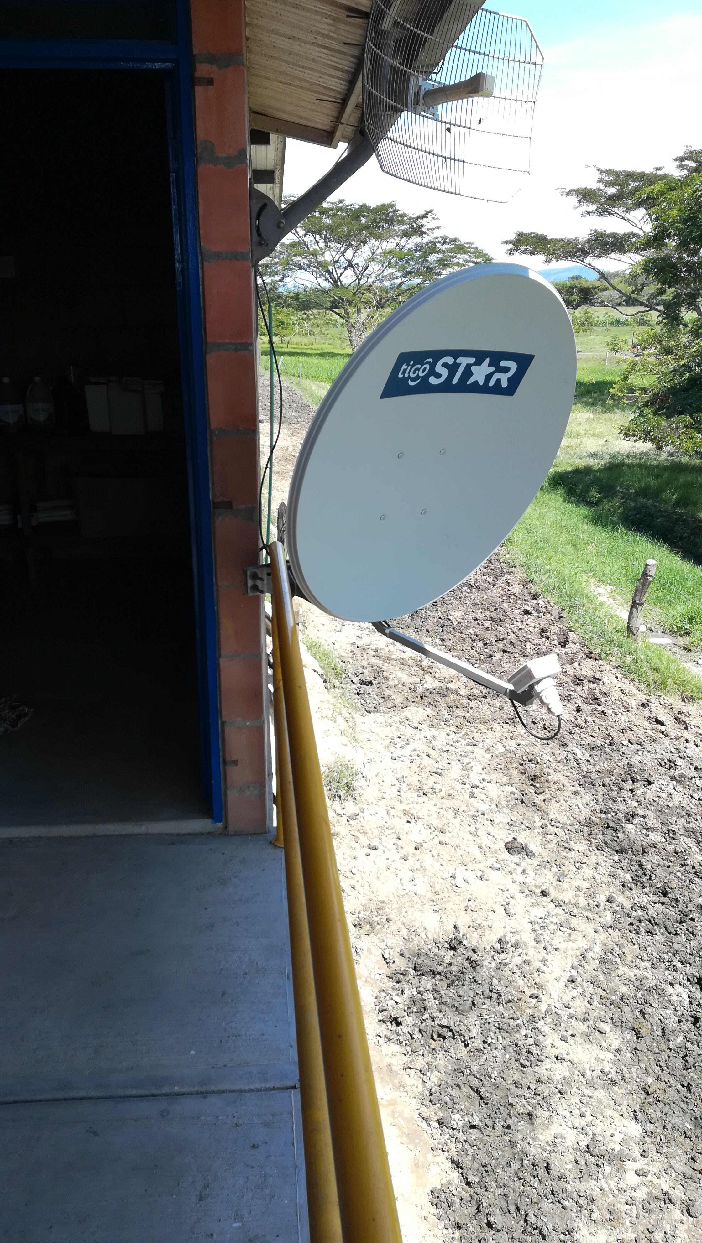

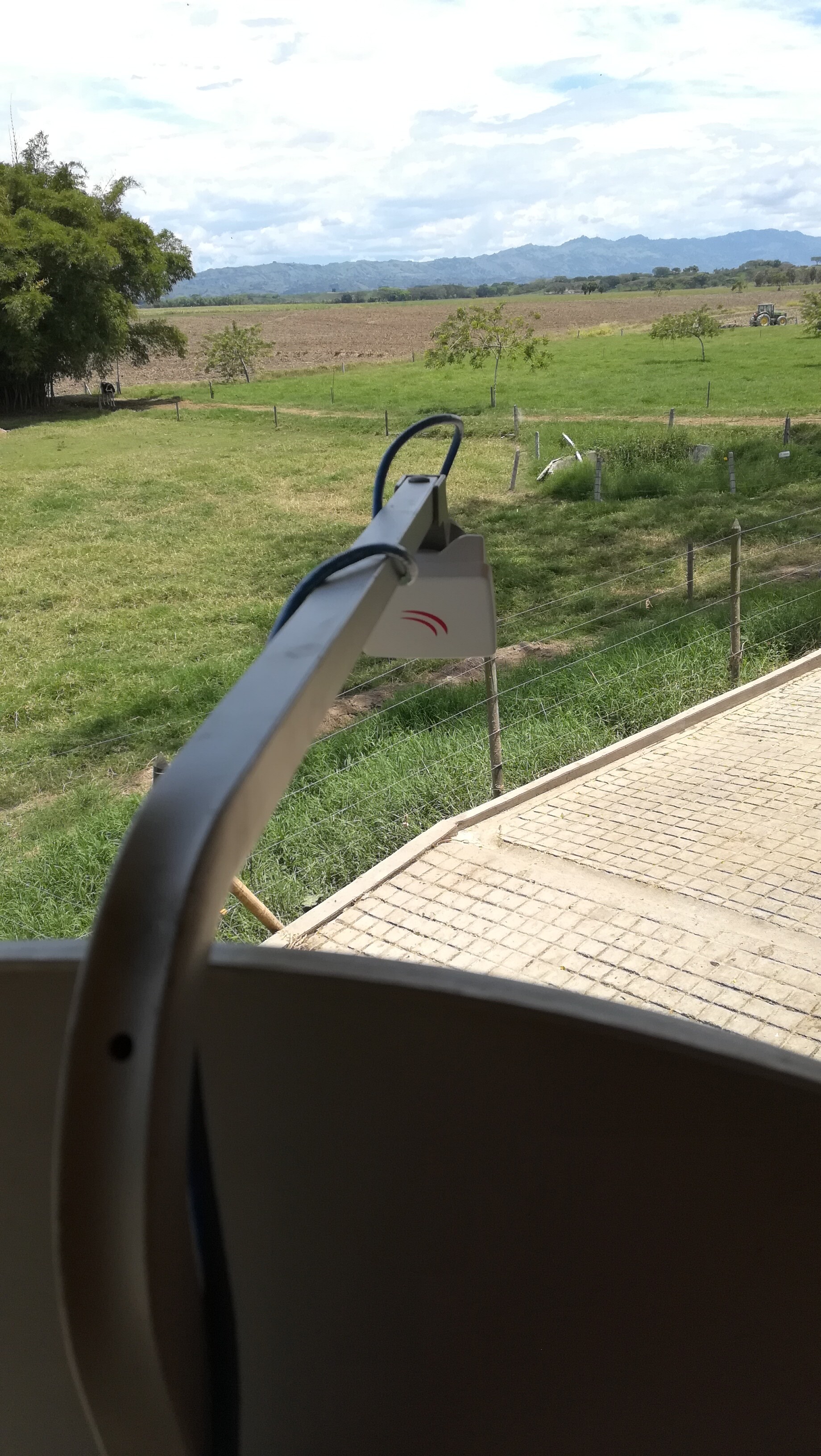

My experience with an LDF5, I mounted it in a 90Cm dish and it was registered in an AP Rocket M5 with levels of -64 and a rate of 102Mb at a distance of 21 Km, I see a DVr that tego with 4 cameras fluid and without conjelations .
Excellent radio.

at which angle must a 60cm dish be pointed to get a straight or 90 degree beam.
