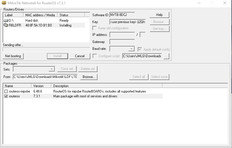

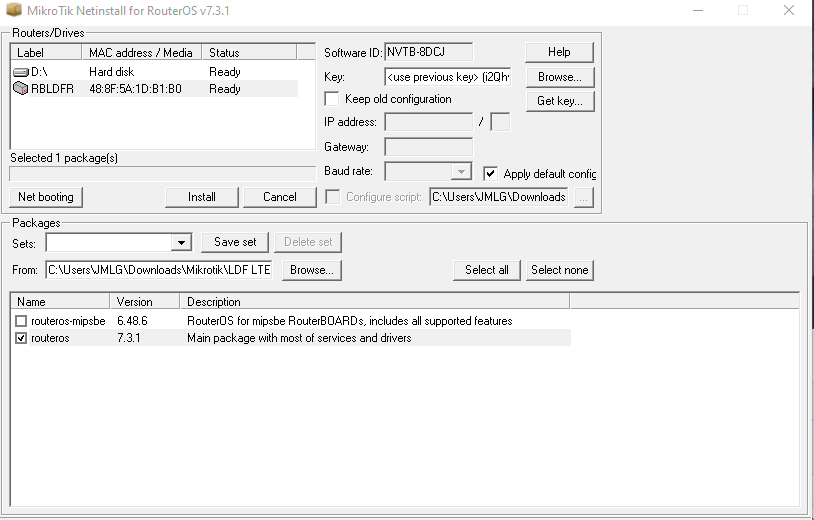

I managed to start it in Netboot mode, launched Netinstall, I can see my LTE6, I try to flash it with routeros-mipsbe-7.3.1.npk (current version) and the option “Apply defaut config” but :
  • it seems to transmit the file well (install then ready)
  • the light remains blue and the software indicates ready.
  • the reboot button does not appear
  • if I unplug nothing has changed

screenshot of Netinstall

Hello to all of you,
Following the answer of the MIKROTIK hotline, my problem is solved.
The model : RBLDFR can only be updated to the version : RouterOS 6.48.6 Long Term.
The more recent firmware does not seem to be compatible.
