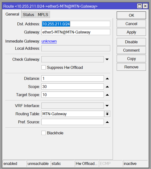

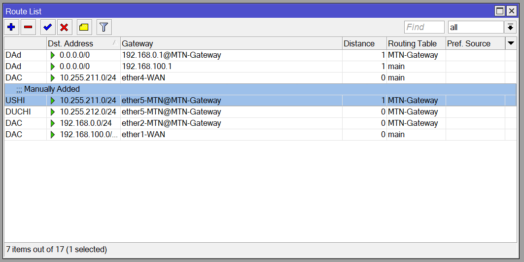

I have two VRF’s running, main and MTN-Gateway. The former has a gateway IP of 10.255.211.1 and the latter 10.255.212.1.
Each of the VRF’s are routing to their own gateway, so I have two WAN interfaces, and two LAN.
So here’s the problem: I’d like to be able to access some of the IP’s on ‘main’ from ‘MTN-Gateway’.
I am at a loss. I have been trying to sort this for days now, with no luck. Any help would be much appreciated
Please see the attached snapshots for some idea of my config.

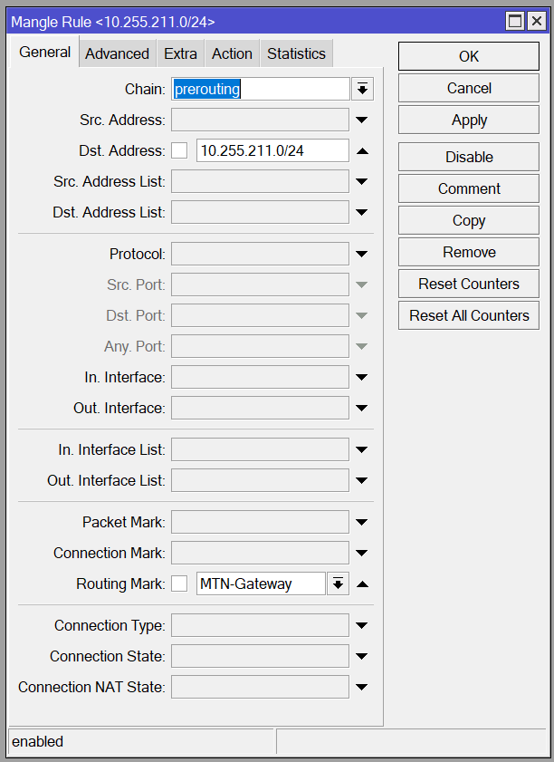

I also tried adding a mangle rule, but I never see any packets traveling through it.
I eventually managed to figure it out. It seems the idea I had of routing everything to the subnet was completely off! Instead you have to add a ‘prerouting’ mangle rule for each subnet and set the correct route-mark. Such as the below…
