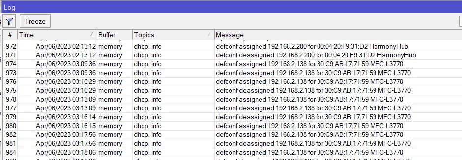

I like looking at the log files to see what’s going on with the MT devices and there is a small annoyance.
There are a few devices on the network that frequently have their DHCP IP assignments assigned and deassigned.
I would rather not see that in the log.
I tried changing the DHCP assignments for those devices to STATIC but the assignments/deassignments are still logged.
Other than changing the devices to a permanently assigned IP (not desireable), is there any way to prevent this logging? Even if it is only for specific devices.
Here’s what I mean:
When you convert this lease to Static, maybe set lease time to a very long time?
I tried that.
It seems the change to static makes it so that the same IP is assigned for that MAC address, but the assignments and deassignments still occur.

I added “/ip dhcp-server alert add disabled=no interface=bridge” and am watching the log (nothing so far).
I do not see any wrong… ( but I suggest you a lease time of 1d 00:00:00 )
No DHCP server conflicts, but still happening:
Is like the timeout is 30s…
