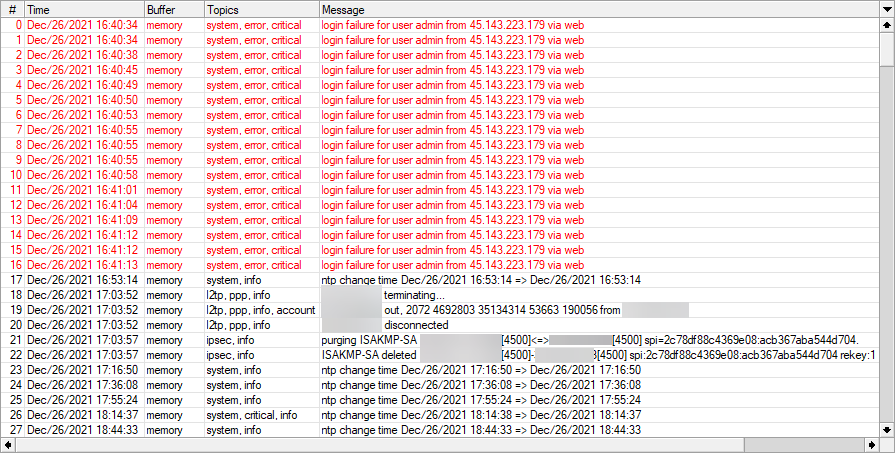

I have a list of ‘allowed’ in IP/Services to stop login attempts but this also blocks LE from verifying.. The feature would be a LOT better if it would allow the challenge verification from any to work and still only allow the administration pages to load from the whitelisted ranges.

I don’t use the web-conf either, except maybe emergency access, but even that is limited… Even if there is never another 0-day, having the service open to the world the has login failures that are annoying in the logs.
Most of the login fails are related to bots, I added a few firewall rules port knocking TCP syn and ICMP rules. After that, I never got any Webfig fail login log. Bear in mind my VPS’s are mostly located at Hetzner, They are all hammered with bots all day long.
