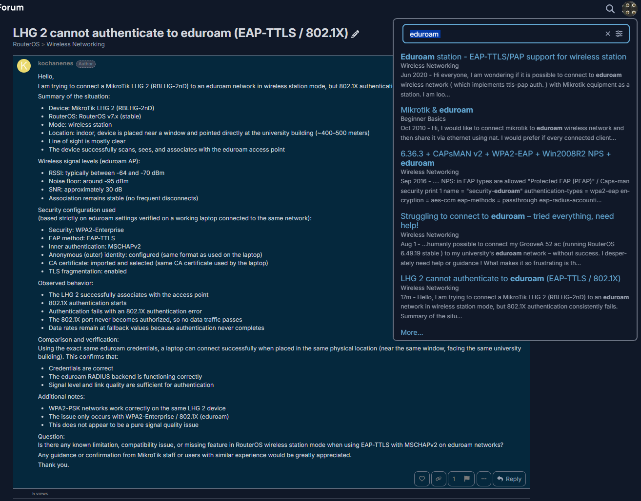

LHG 2 cannot authenticate to eduroam (EAP-TTLS / 802.1X)
I am trying to connect a MikroTik LHG 2 (RBLHG-2nD) to an eduroam network in wireless station mode, but 802.1X authentication consistently fails.
Summary of the situation:
  • Device: MikroTik LHG 2 (RBLHG-2nD)
  • RouterOS: RouterOS v7.x (stable)
  • Mode: wireless station
  • Location: indoor, device is placed near a window and pointed directly at the university building (~400–500 meters)
  • Line of sight is mostly clear
  • The device successfully scans, sees, and associates with the eduroam access point
Wireless signal levels (eduroam AP):
  • RSSI: typically between -64 and -70 dBm
  • Noise floor: around -95 dBm
  • SNR: approximately 30 dB
  • Association remains stable (no frequent disconnects)
Security configuration used
(based strictly on eduroam settings verified on a working laptop connected to the same network):
  • Security: WPA2-Enterprise
  • EAP method: EAP-TTLS
  • Inner authentication: MSCHAPv2
  • Anonymous (outer) identity: configured (same format as used on the laptop)
  • CA certificate: imported and selected (same CA certificate used by the laptop)
  • TLS fragmentation: enabled
Observed behavior:
  • The LHG 2 successfully associates with the access point
  • 802.1X authentication starts
  • Authentication fails with an 802.1X authentication error
  • The 802.1X port never becomes authorized, so no data traffic passes
  • Data rates remain at fallback values because authentication never completes
Comparison and verification:
Using the exact same eduroam credentials, a laptop can connect successfully when placed in the same physical location (near the same window, facing the same university building). This confirms that:
  • Credentials are correct
  • The eduroam RADIUS backend is functioning correctly
  • Signal level and link quality are sufficient for authentication
Additional notes:
  • WPA2-PSK networks work correctly on the same LHG 2 device
  • The issue only occurs with WPA2-Enterprise / 802.1X (eduroam)
  • This does not appear to be a pure signal quality issue
Question:
Is there any known limitation, compatibility issue, or missing feature in RouterOS wireless station mode when using EAP-TTLS with MSCHAPv2 on eduroam networks?
Any guidance or confirmation from MikroTik staff or users with similar experience would be greatly appreciated.
Thank you.

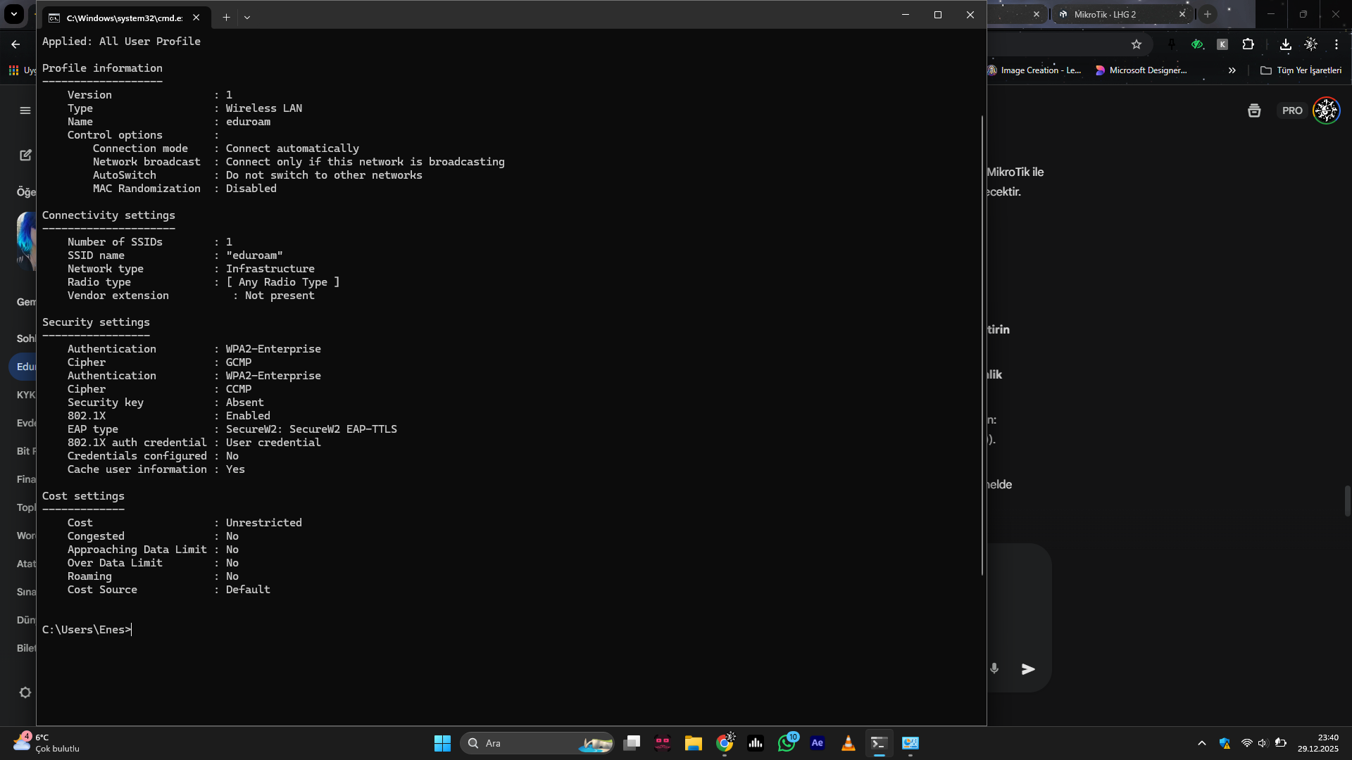

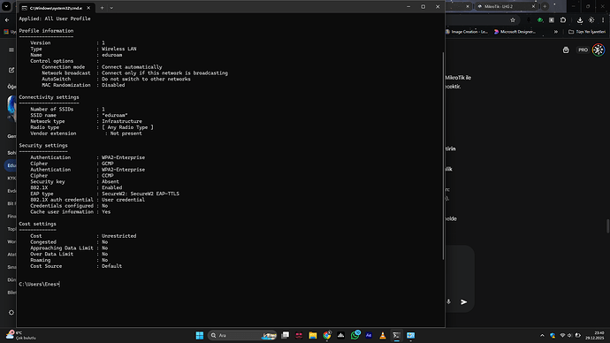

As a reference, my laptop connects perfectly to the same eduroam network using EAP-TTLS / PAP via the SecureW2 agent. While the network provides both 2.4 GHz and 5 GHz, my laptop connects via 5 GHz (Channel 52). Since the LHG 2 is a legacy device limited to the 2.4 GHz band, I suspect there might be a driver-level limitation in RouterOS v7 for this specific hardware when handling TTLS-PAP over 2.4 GHz.

I checked the official IT documentation from my university. The guide explicitly states that for EAP-TTLS, the Phase 2 (Inner Authentication) must be set to PAP. Here is the official link from the University’s IT Department: [https://bidb.akdeniz.edu.tr/tr/eduroam_baglanti_ayarlariandroid-12403\]. Even though the guide is shown for Android, the RADIUS server configuration is fixed to PAP for all clients on this campus.
Ok it seems that RouterOS does not support PAP, only MSCHAPv2.
