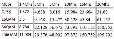

This is a theoretical speed too, http://anisimoff.org/eng/lte_throughput_calculator.html give me a table
