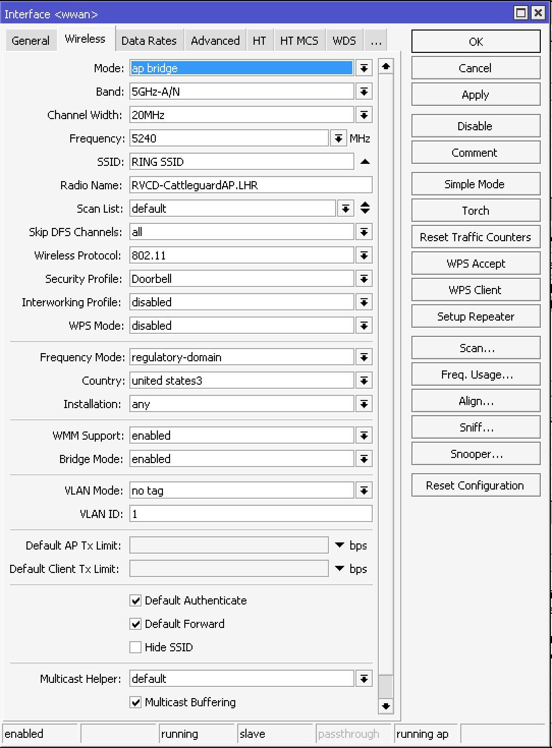

Monday, I erected an RBLHG-5nD to feed two Ring security cameras only 190 meters away. The aim seems to be on the money, and the LHG is seeing -53 and -59 from the cameras. However, the cameras are seeing -74 and -72 from the LHG, insufficient to operate. Upon examination, the LHG seems to be stuck in (6dBm) channel mode. I used to be able to jar them out of that mode by selecting high-range frequencies and outdoor/any operation, but I can’t get that to work with this unit. I have tried every combination of indoor/outdoor/any with both low and high frequencies, and the highest tx power I can achieve is 6dBm. What am I doing wrong?
I’m in regulatory-domain (no other choice), united states3, on v7.13.2.
One oddity: since I had two cameras I needed to serve, I had to upgrade the unit to an L4 license so I could run ap bridge. Did I screw myself in doing that? I have tried all of the above combinations in straight bridge mode as well, but of course that doesn’t downgrade the license to PTP.

Try setting the antenna gain parameter to 0
no need to netinstall
https://help.mikrotik.com/docs/display/RKB/Downgrading+RouterOS
also if you DO need to netinstall, you can do it remotely by telling it to try ethernet instead of nand for the next reboot,and then run netinstall and reboot it.
Yeah, that old trick failed me – there IS no Antenna Gain field anymore!

Ooh! Super-great catch! I’ve never seen that. That’s fast and easy enough for me to do tomorrow morning. I think you just saved me a lot of grief. Thanks!
Or set up a super channel
Or use the terminal command
/interface wireless
set [ find default-name=wlan1 ]  antenna-gain=0
PS Usually reflashing via net install removes the region lock and the superchannel appears
Bingo! :partying_face:
I’m really surprised (but so grateful) that they left that in the CLI!
