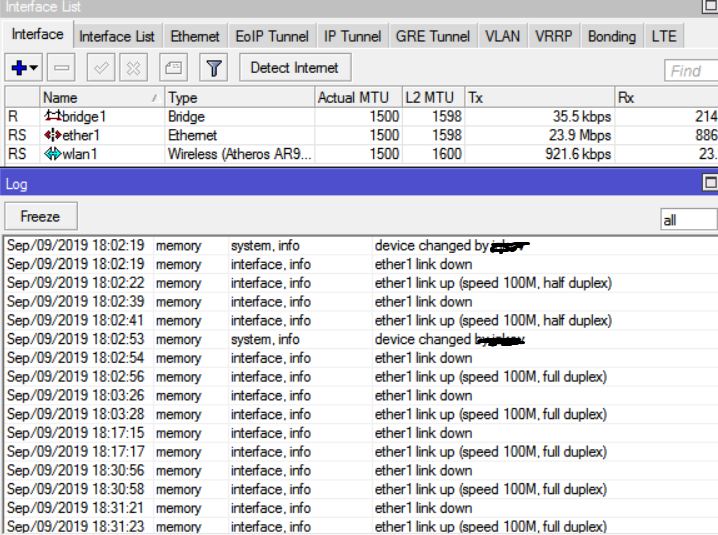

I need a little help with LHG5.
Have LHG 5 connected with cat5 to OmniTik PoE, in a day time (when temp. is higher) I get ether1 link down all the time
I tried changing Omnitik (because I don’t have extra LHG in my hand) , cables and etc. but no change, ethernet continues to disconnect.
I already have deployed 20 LHG5 in my network only 2 have that kind of problem.
What is important to mention is when temp. drops below 20 degrees (night time) the problem disappears .
Mikrotik or anyone else is that a hardware problem?
This may be a cable problem or a RJ45 problem.
Yes I know it looks that way but I tried different cables. ether continue to disconnect, tomorrow I’ll put new LHG.
