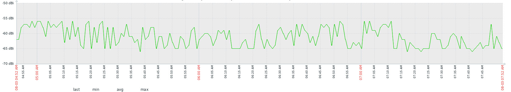

the links themselves stay up and running but the data randomly drops to 6Mbps for a few seconds and then goes back up to 450Mbps - this is around a 5km link

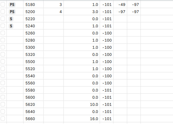

the attached signal image seems to show the selected frequency 5500 shouldnt have any issues

The signal levels do seem to jump around a lot, but we have verified there is nothing in between getting in the way of LOS
im hoping someone might have an idea to what could be causing the issues...
