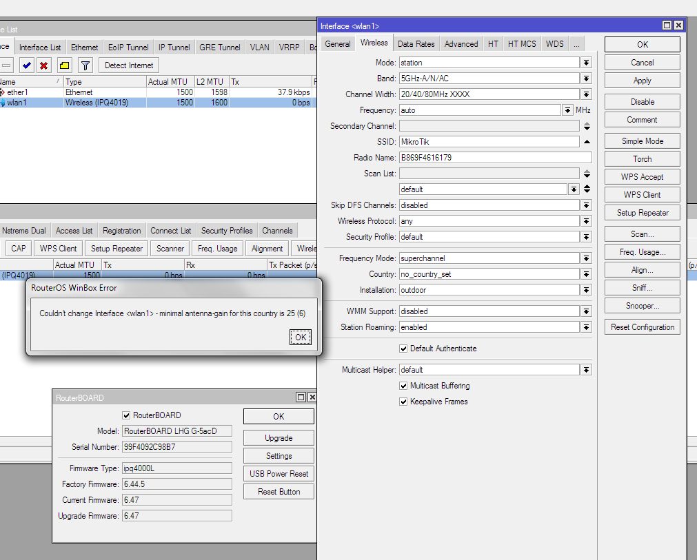

LHG 5AC Can't set regulatory domain
Hi guys, when I try to set regulatory domain I get the error “Couldn’t change interface - minimal antenna gain for this country is 25 (6)”
I can’t see anywhere antenna gain as a setting, am I missing something?
Mikrotik removed “antenna gain” from the WinBox menu’s in 6.47 and 7.0beta8.
The only way to change the antenna gain now is via the CLI (“New Terminal”).

@bpwl I don’t seem quite to get the hang of this console.. I honestly expected something more unix/linux like on a mikrotik (it’s my first)
[admin@MikroTik] /interface wireless> /interface wireless set antenna-gain=25
numbers:
What numbers?! :smiley:
Command set takes a parameter (let’s call it non-attribute) in form of single digit which defines to which entity it actually applies. If you don’t pass the number, you’re asked to enter it. Some (most) of times you can write name of entity instead.
In your particular case there could be more than one wireless interface present … and the number is … if you first execute /interface wireless print, it’ll show index numbers in first column. That’s the number you want to use with subsequent issues of set command. Just beware, the index numbers are dynamic and only valid until next print is executed. Also they don’t exist before print is executed for the first time.
Or, as I already mentioned, use interface name instead …
/interface wireless set wlan1 antenna-gain=25
Fixed:
/interface wireless set "wlan1" antenna-gain=25
The wlan name has to be in quotes. The “numbers” part would be the name: wlan1 or whatever you have set.
