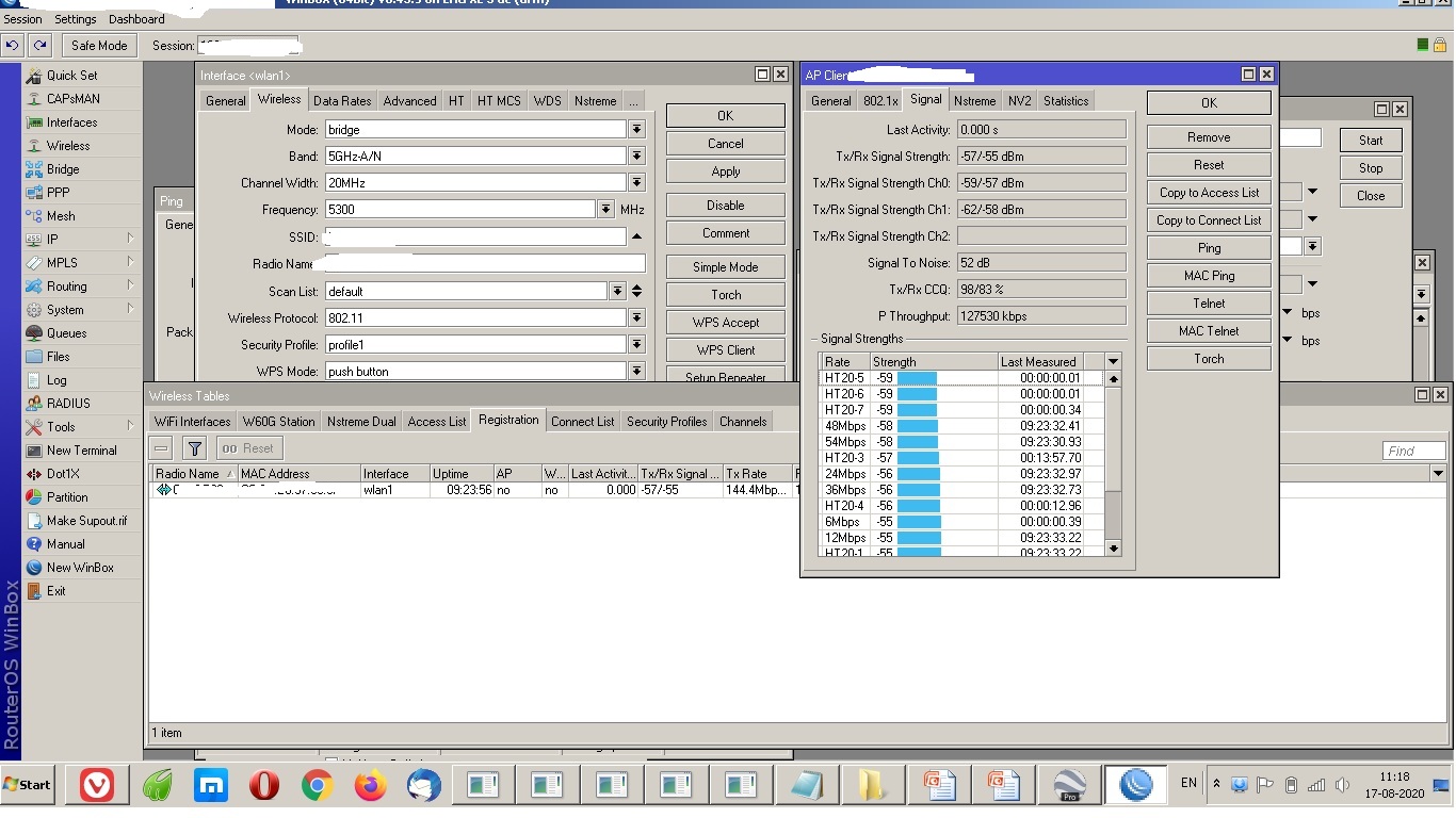

it is the newest long term firmware. please refer to the image.
the problem is that it is not shifting to mcs rates at all

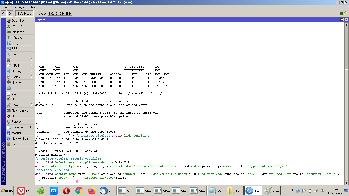

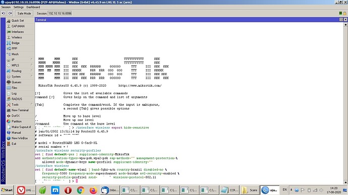

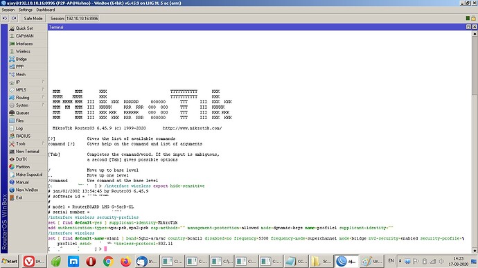

Can you please share your config (and remove any non relevant information):
/interface wireless export hide-sensitive

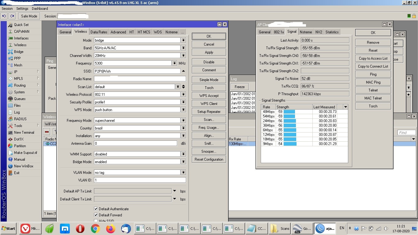

Why are you using superchannel?
What kind of security settings are you using?
Im sharing the pics. Tried everything but of no use. Im using the mikrotik sector (mAntBox 19s) at same location in a/n/ac mode and it is working fine.
Is it possible that the Lhg itself is faulty?
Using superchannel bcoz its takes a lot of time in radar detect
Couple of things:
  • You can copy from the terminal, no need to take screenshots…
  • Antenna gain can (should?) be set to 19
  • Only use WPA2/AES (and nothing else)
You know that you are currently not compliant to regulations?

Tried the settings suggested by you but its the same result.
as far as compliance is concerned, trying these settings on temporary basis to check if the link works
Try 6.47.1, there are some ARM fixes missing in this old Long term
