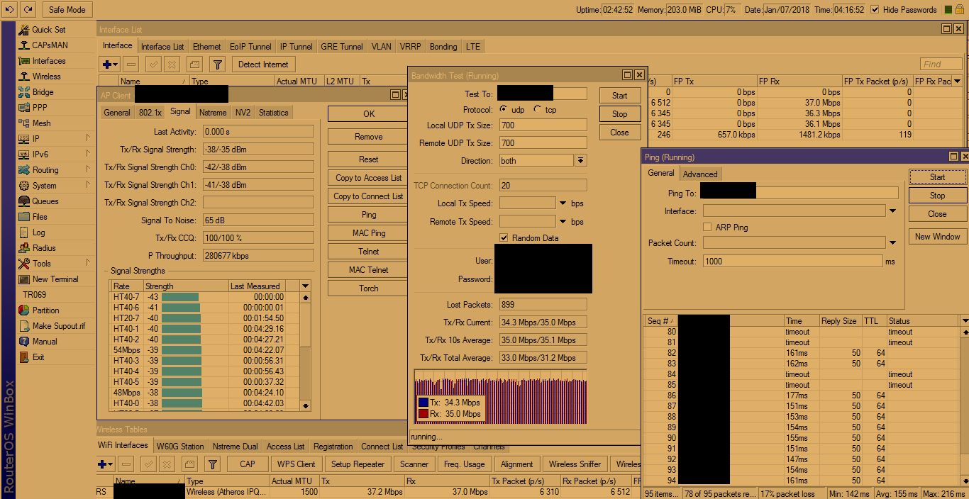

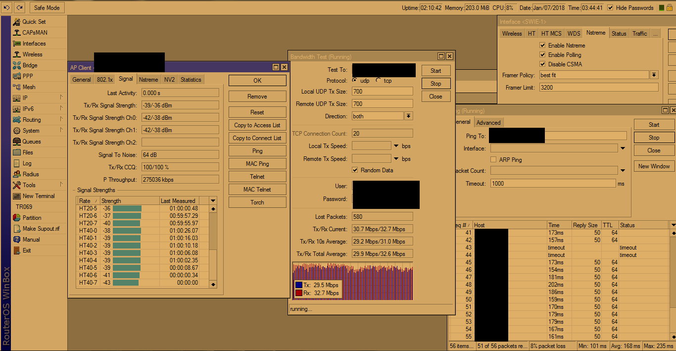

Distance: ~330m
btest LHG AC β†’ wireless n nstreme β†’ SXT Lite5 β†’ switch tplink β†’ gigabit fiber β†’ switch tplink β†’ rb750r2
ping LHG AC β†’ wireless n nstreme β†’ SXT Lite5 β†’ switch tplink β†’ omnitik
Small real traffic and OSPF communication goes thru link in parallel with btest, fiber have more free badhwith than needed :wink:
35Mbps? Well that sucks :frowning:
With 802.11 n device on one side, this tells nothing…

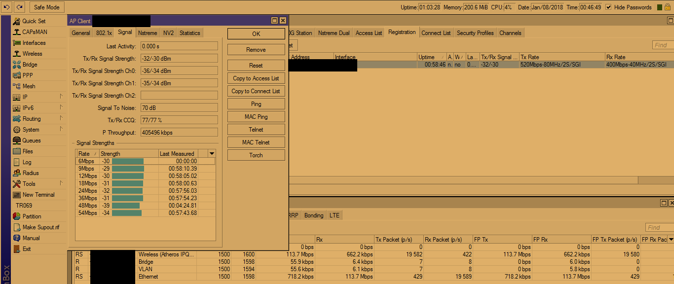

Ok i replaced second sxt:
Due to bugs in ROS: channel, tx power etc is not optimized. On current channel we have many interferences.

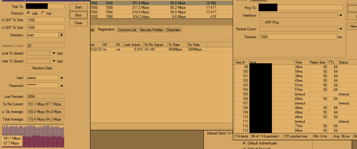

MT Support recommended to update to 6.42rc4 i updated to 6.42rc6 and change wireless settings works now. I tested nstreme, nv2 and 802.11 in AC on nstreme and nv2 it was unstable - frequent and random disconnections, traffic stops and wireless tx 6M.
In attachment test on 802.11 AC 20/40
Limit you Power about 12-15db to get -55 / -55
And test speed again!
