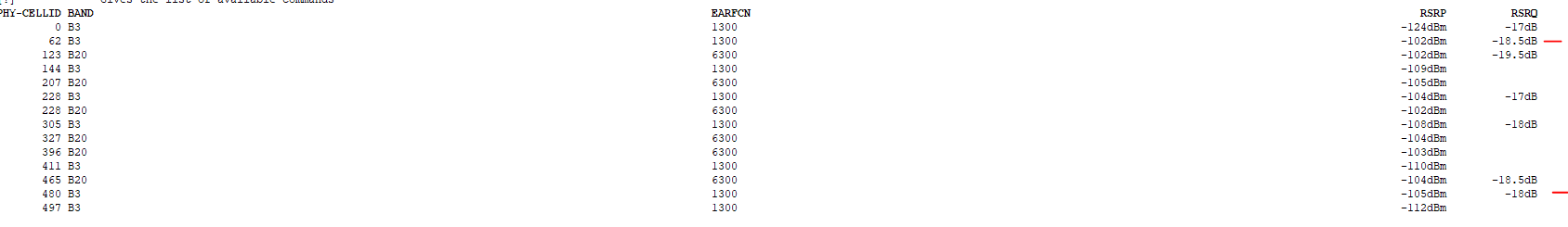

You need EARFCN and PCI
/interface lte at-chat lte1 input=“AT*Cell=2,3,EARFCN”,PCI"
you can see these informations with :
\interface lte> cell-monitor
number: lte1
and if you are connected to proper Tower, then you can read this info just from current connection details in Cellular tab

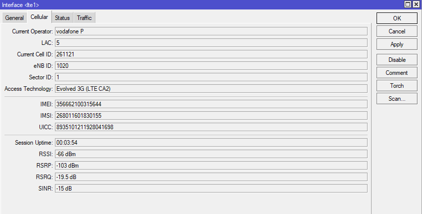

Thanks mate but which tab do you have that info? after I go the cell It only appears this…

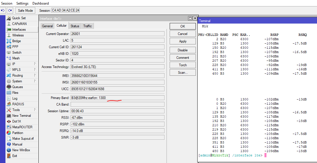

Also another question, sorry…But since I have an RBLHGR&R11e-LTE6 isn’t suppose to have aggregation? Need to turn on, or the signal is so crap that only connects to one?

Update ROS to newer and you see that cell-monitor will be works better and The Cellular tab will be with more details.
For which version? The lastest? Isn’t any bug which will affect my already poor performance? XD
orvis
You are a administrator of your device. You should know all ± of ROS. You can select beta channel or stable. Or even ROS7.
But do a upgrade !

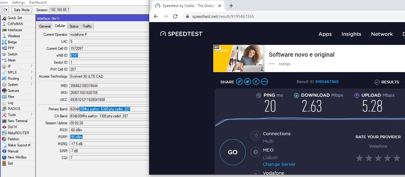

Hey, found the best tower, speed reaches like 17mbps OMG…Got only one problem, when connect It doesn’t show me the PHY CELL ID.
Do you know any way to find this?
Thanks.
Use WinBox 3.22
enable logs with topic=lte
Log - use filters for messages with CREG or $CREG
The last one is phy-cellid in hex. Use Windows Calc (calc.exe) in Programmer mode to enter hex from log and see the proper decimal value.
Thanks a lot mate, It doesn’t appear because the cell id is 0 lololol so when I put 000 or 0 the tik accepts :slight_smile:
