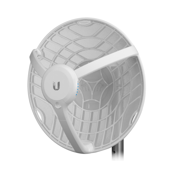

LHG 60 clone from ubiquti
Wow a perfect copy of mikrotik LHG 60 with integrated 5 Ghz backup there are no more info about specs
http://cdn.shopify.com/s/files/1/1439/1668/products/AF60_Port_grande.png?v=1566495874
From their webpage source - also twice as expensive, 299$ for a single unit.
Why does that look like some sort of render and not an actual photo?
