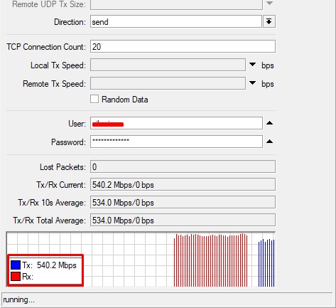

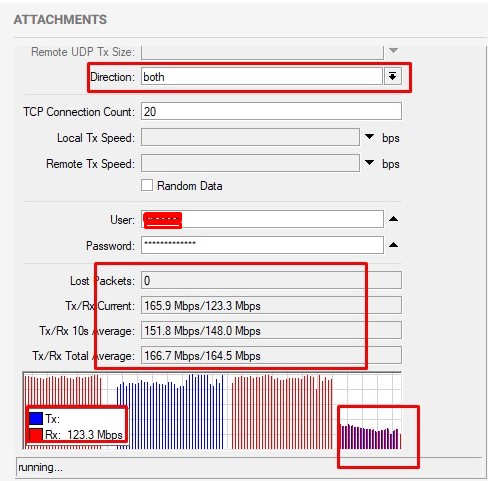

I can not pass more than tx = 410 Mbps and rx = 400 Mbps. If I do the test with tx and rx the speed it gives me is tx = 210 and rx = 180

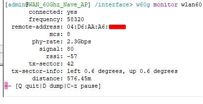

attached alignment configuration (not to say that there is direct vision without problems)

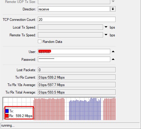

How do you test the speed?
the last test I have done gives me separately tx = 598 and rx 587
If I do the test with both gives me tx = 199 / rx = 187

test speed on different devices you are maxing out one core of the devices CPU and this is your bottleneck and not the wireless interface

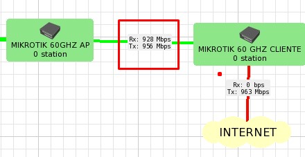

Attached screenshot of the dude where he measures the speed between the two links.
THANK YOU
Great :slight_smile: These links are almost as good as a fiber.
