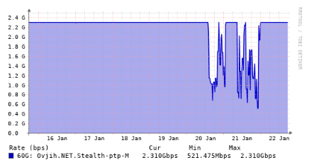

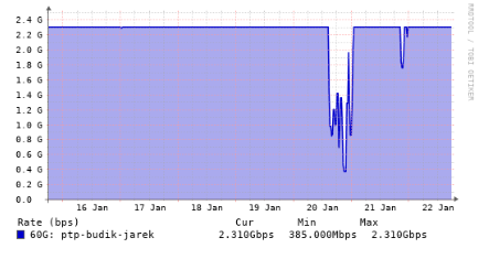

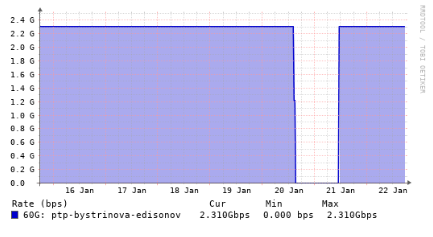

I have many LHG 60G kits as a ptp links with various range deployed. I have never bothered about upgrading them much often as our routers, so they basically all stayed at MT version 6.47.7 and factory FW 6.42.1. Few days ago I have upgraded all links one by one both MT and FW version 6.49.11 and some weird stuff happened. All of the links dropped rapidly on Rate, quality, rssi and stability. They were perfectly stable before the point of upgrade. After noticing I have reverted both FW and MT version to last known good versions 6.42.1 FW and 6.47.7 MT. The date of interest in the graph are from 20-21.1.2024
Link #1 went completely down, unable to pair:
Link #2
Link #3

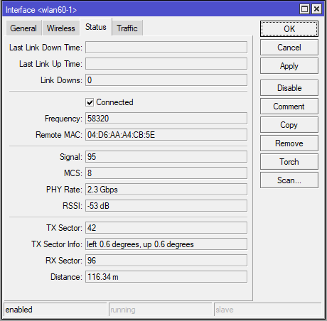

This is how it looks after downgrade again:
Rock solid. But when the fw was 6.49.11 the signa, rate, was jumping for two days terribly. The link also went down many times.
