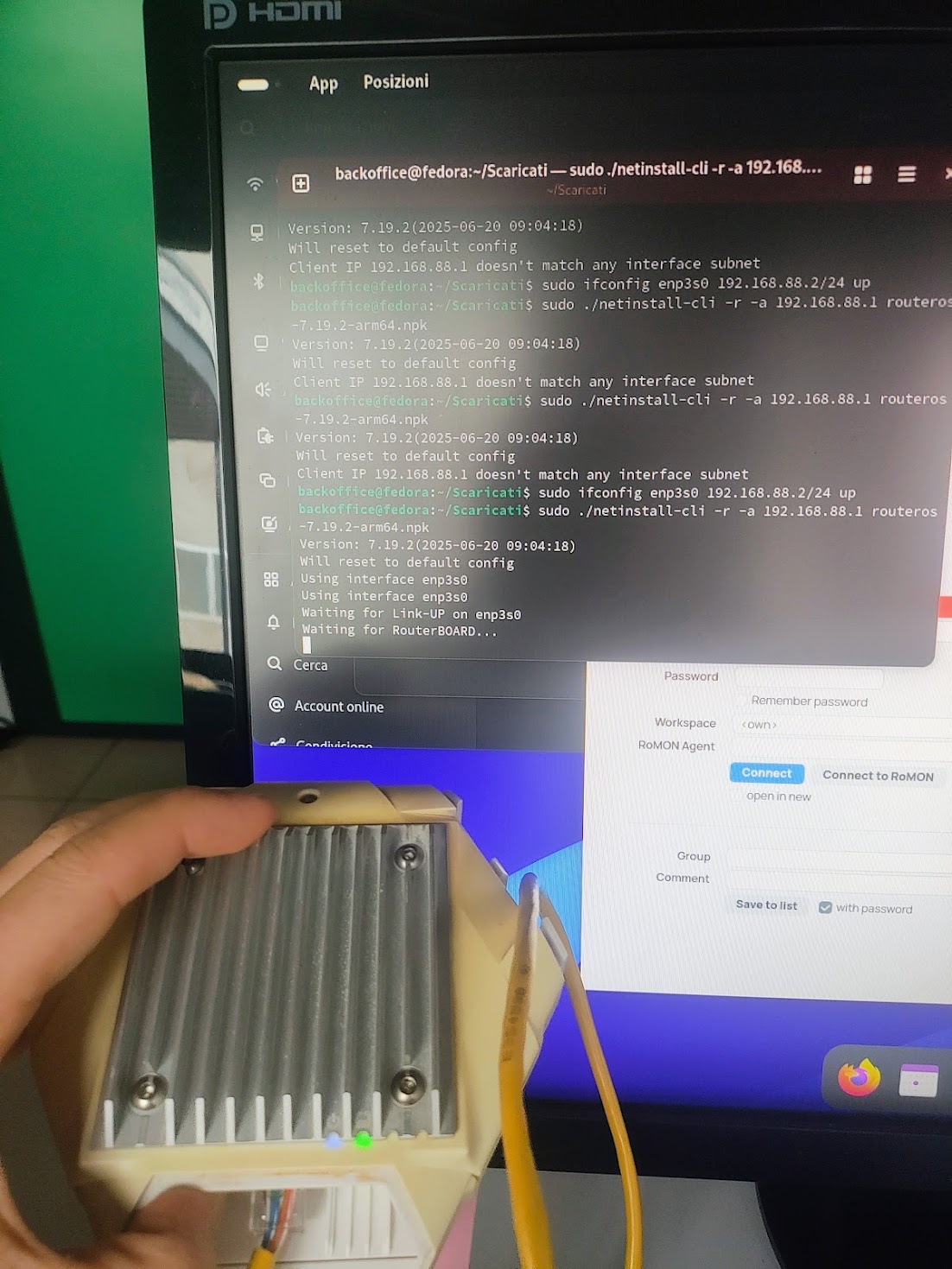

Lhg almost dead! no winbox no reset no access and rebooting when connecting lan
hi guys!
i tried resetting lhg without succes.
Then i tried connecting via winbox. no success.
Then i tried with netinstall on 2 different pc and nothing happened.
I saw that connecting to the lan cable the lhgg tries to get the connection but with no result.
is it time to put this device on the garbage?

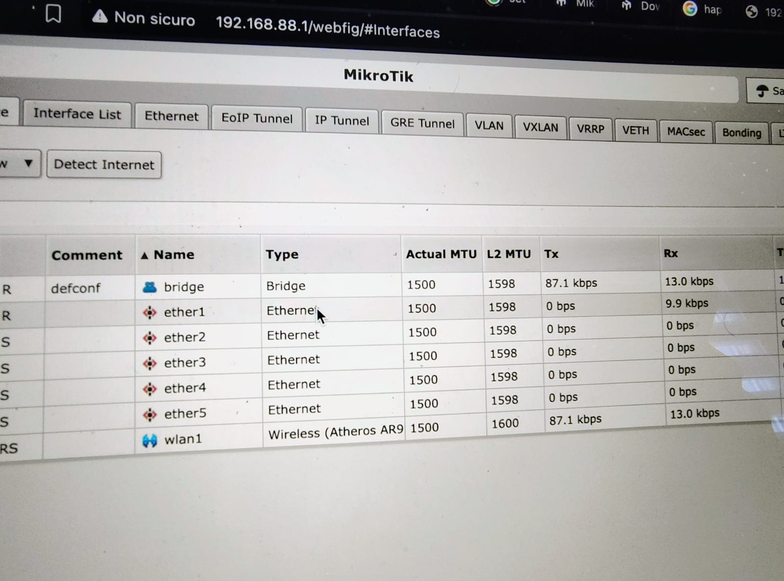

i tried also with an Hap ac connected to the lhg.. but on winbox is not showing anything by mac adress even if i see a “R” next to the port where i’m connected to.

tried with linux.. and same problem as the win or macos ..
the ip it’s getting is quite strange..
ip by lan 169.254.144.77
resetting procedure holding reset by 5 secs and pluggin in the cable is not working.

done it both via windows and via linux..
the problem still exists…
i finished all the standard approaches…
Also with the “dumb” switch interposed?
If you hock the device up to a pc with Linux and run like wireshark or tcpdump, to determind if the device has some ip traffic on the ethernet port.
Will be more informant to the community and MikroTik. To see if the device is very ded or just senile :slight_smile: . Don’t give up.
i will try it.. but connected to the hap ac of mikrotik i see RX and TX on ethernet port..
Also, try without forcing the 192.168.88.1 address, maybe that is the issue, the LHG has not (anymore) that IP address.

since i see it from the hap..
is it possible to give it a fixed ip adress and enter via hap …? so entering the router then → lhgg ?
