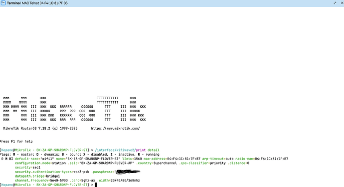

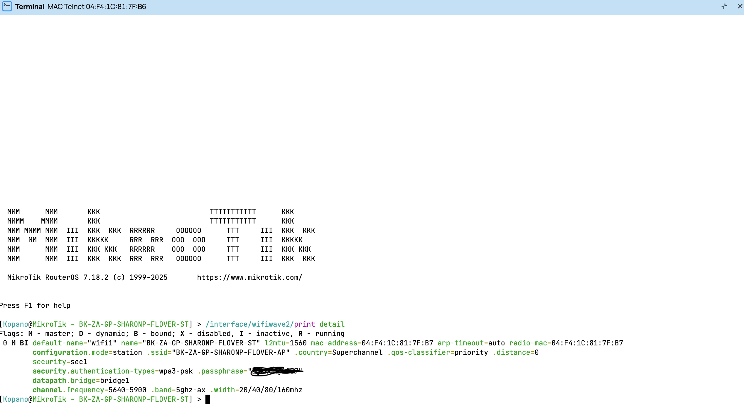

above is settings for the station.. Unfortunately due to not being able to connect to the AP remotely or via mactelnet because the station cant even ping the AP even though its connected to it.
Above is the response I get when I try to set the ST to station-bridge mode.. it says no such item exists
