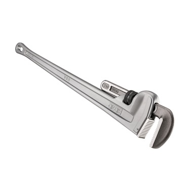

Personally I prefer as a complement to the shouting a 12" aluminium american style wrench:
it is light enough to be easily waved with energy in front of the device, and it has a kind of threatening mechanical look, devices know by instinct that it can do real damage :wink:.
