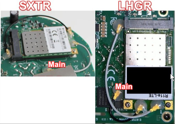

yes, the R11e-LTE6 is a MIMO 2x2 device, it have a two connectors for two antennas.
You can just check the webpage to cofirm this, means you not must open a device.
https://mikrotik.com/product/r11e_lte6
as bonus this are a MAIN connectors at PCB of SXTR and LHGR
