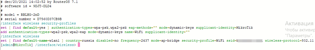

please run
/interface wireless config export hide-sensitive
and post output. make sure to scrub anything you care about by replacing it with ****

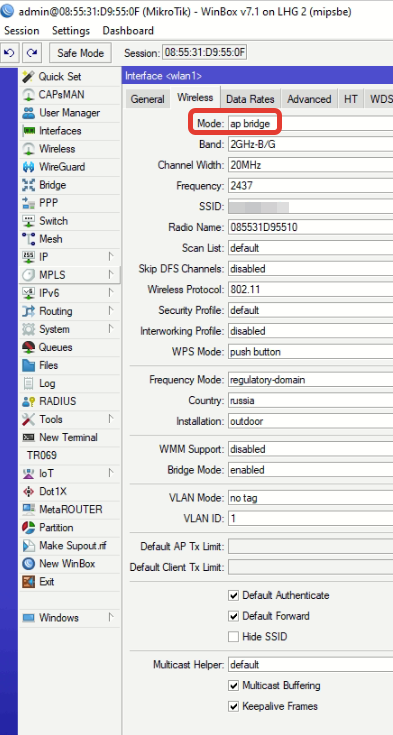

Mode ap-bridge?
I’ve attached screenshots of winbox.
What are the log messages within the AP-bridge, once the second client tries to connect and what messages do the clients get when unable to connect?
