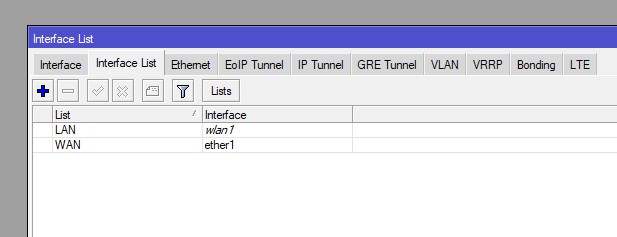

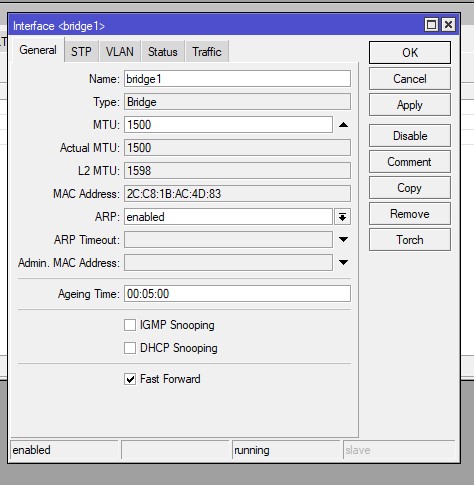

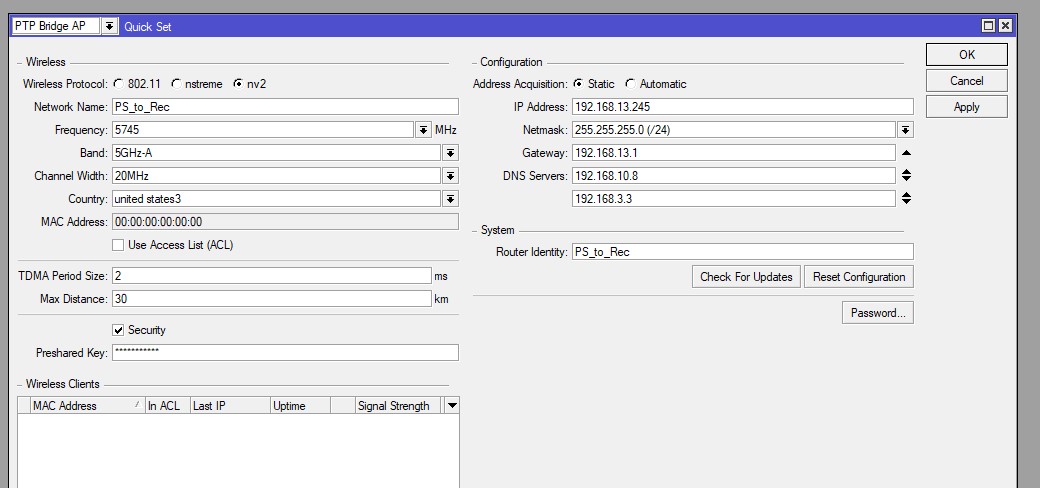

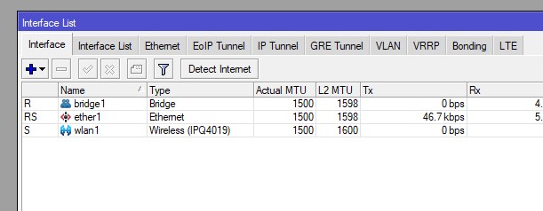

Newb here that needs some help. I am a Tech II at for municipality and we are trying out the LHG dished vs Unifi. I configured a couple LHG5 dishes in our “lab” environment (really our office) and it is discovered by Winbox and I can ping it and they can also talk with the far side just being wireless. When I plug one of the dishes into our network I cannot ping it and Winbox doesn’t see it either. My “lab” enviroment the near dish is plugged into a USB network adaptor set on the same subnet as I configured the dish. Below is a basic diagram and images of my config. I need some help on this or even directed to a previous post of what I am probably configuring wrong.
