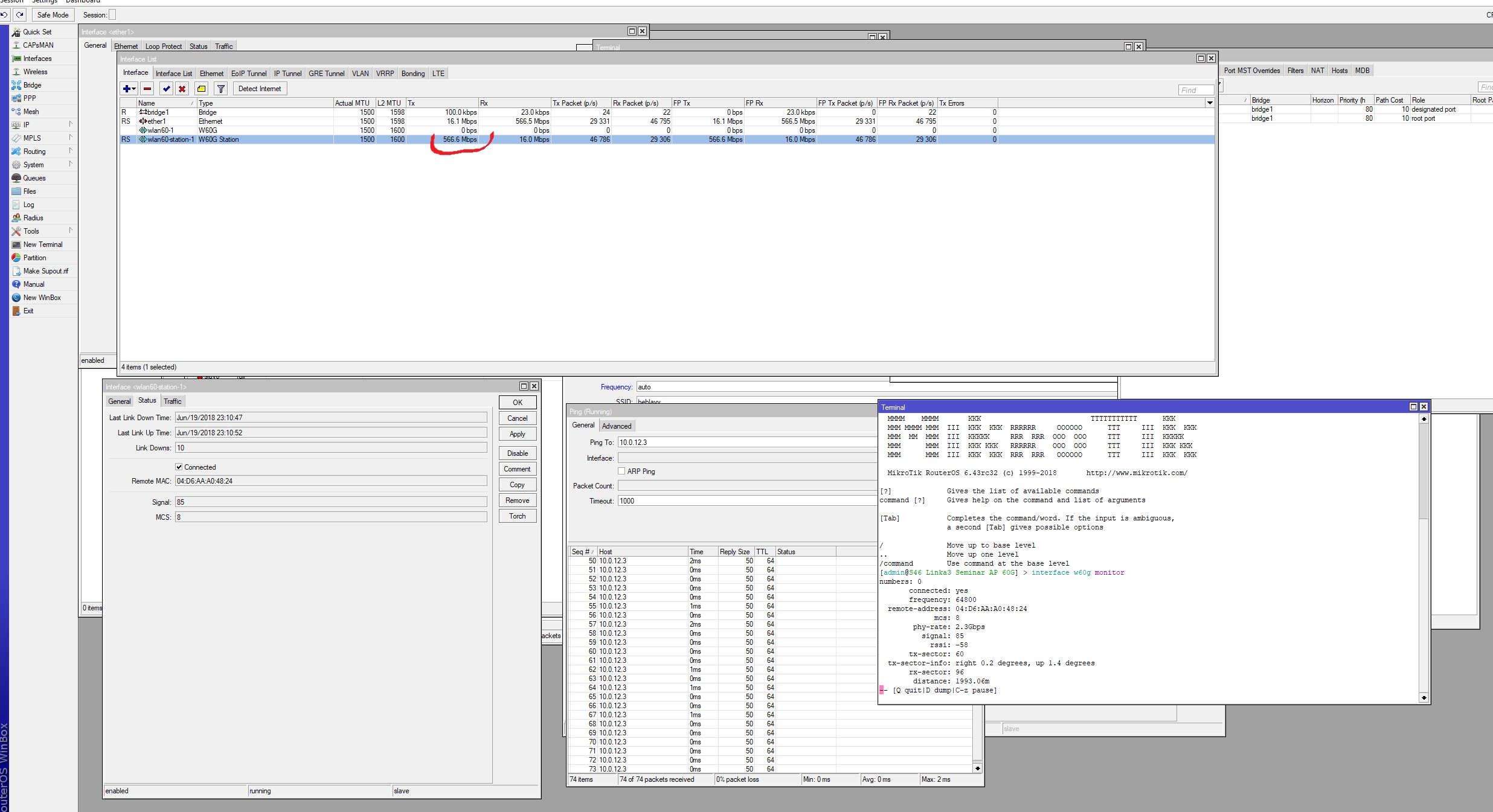

LHG60 2km
BT TCP from CCR 1016
Did you mean exactly 2.000 meters or 1900 meters or 2100 meters? Becuse in 60G every few meters are important.
I see 1993.06 meters in post

Look on picture Terminal distance 1993m

Even from screenshots we can see that You can align it more precisely tx-sector-info should show 0.2 on both planes, or “Centre” if You are using latest RC
On sunny day You should get full speed on this link.
So, what is the maximum theoretical distance in clear and sunny day? Also, what speed can be expected on that maximum distance?
I mean real distace, not from integral MT monitor. I don’t trust mikrotik internal range meter, it can say about 3 km when actually link about 120 meters.
I measured this link on google earth 1970m other link on wAP60G show 236m google earth show 240m Mikrotik measure quite correct
