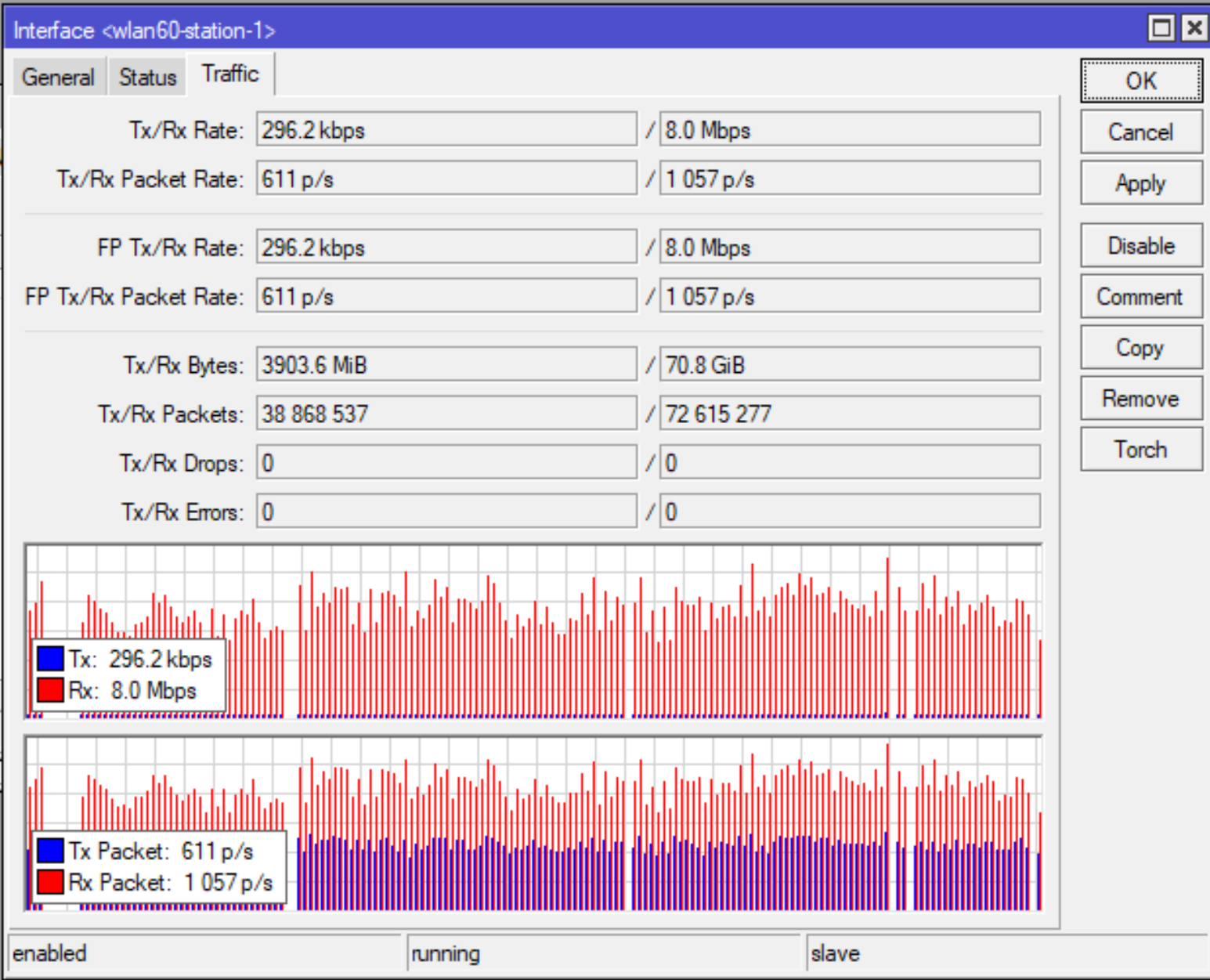

hi guys, for a tvcc survillance , we installed one link with two devices Lhg60G.
The link is very short, maybe bot up 200mt, we have a throughput up to 1Gbps during the test with BTest, but during the normal working we have continuos holes in the throughput, as to picture, during the holes the Images are freezed
Any ideas ?

First five to ten minutes device is “learning” - there will be some drops in traffic during this period. We would recommend testing with traffic generated outside testing system (BTest is not the best tool to be used on device under test) If this issue repeats please send us supout.rif file while running latest Beta versions to support@mikrotik.com

thanks for your reply, the link has been up for at least 15 hours, and we tried to perform a BTest from a 750 Gr3 before the link to a RB3011 after the link, this can be defined truthfully ?
many thanks
What RouterOS version are you using? Are you moving open Winbox screen around? Do you have stable connection to the device you are monitoring?
RSSi -60 @200m is quite bad, allign again, your goal shoud be something about -50
