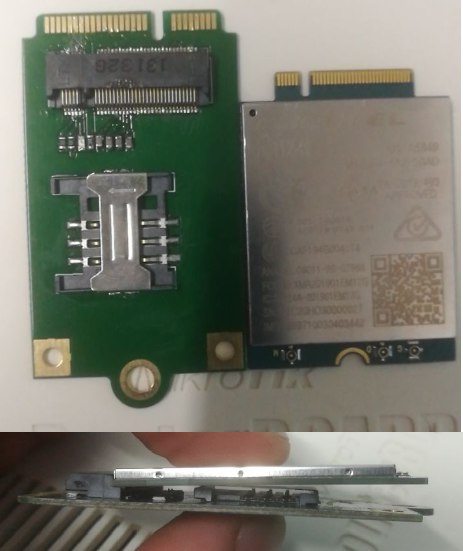

I know it’s been a while but just as an update: the problem was mechanical in nature. The heat transfer pad on top of the modem was pressing the m.2 to pcie adapter’s sim slot and causing a short. Replacing the original pad with a thinner one solved the issue.

This is know issue and at other devices too.
People buy chaep m.2 adapters and they have a sim slot on top… who give problems what you say. Solution is unsolder that simslot or unscrew the screw a little :slight_smile:

To fix I placed a dummy sim card that came with a pack of sim card adapters into the m.2 to pcie sim slot and this keeps it from shorting out. Works great now.
