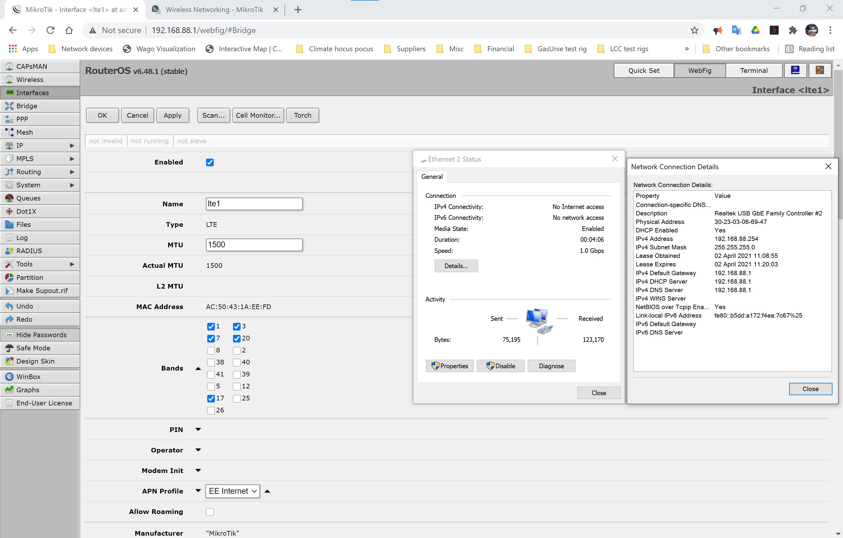

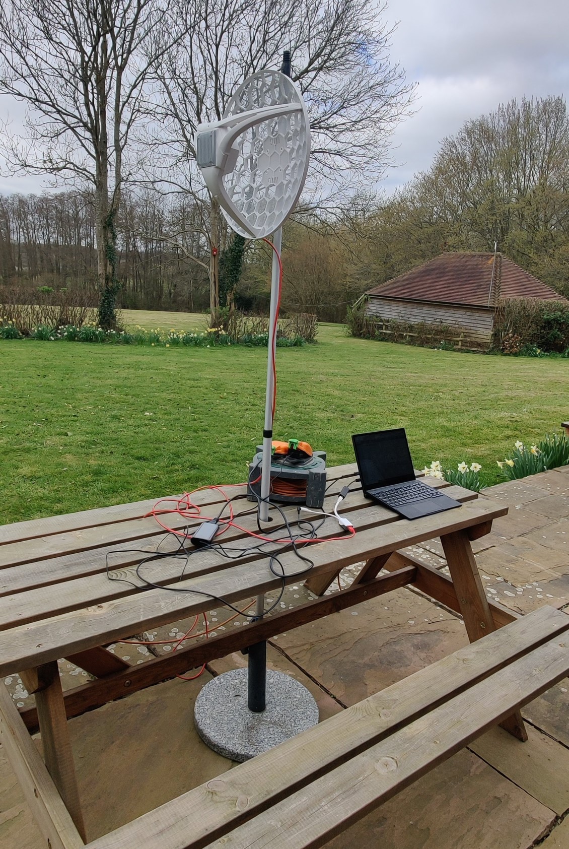

This is my setup which is just for test purposes. I got fed up with climbing up and down that ladder.
I can get 2-3 Mbps on my mobile phone at this location.

Once dried out I have managed to get an internet connection on it but for some strange reason I am unable to get a simultaneous internet connection and maintain connection to the web interface for setup and alignment purposes.
