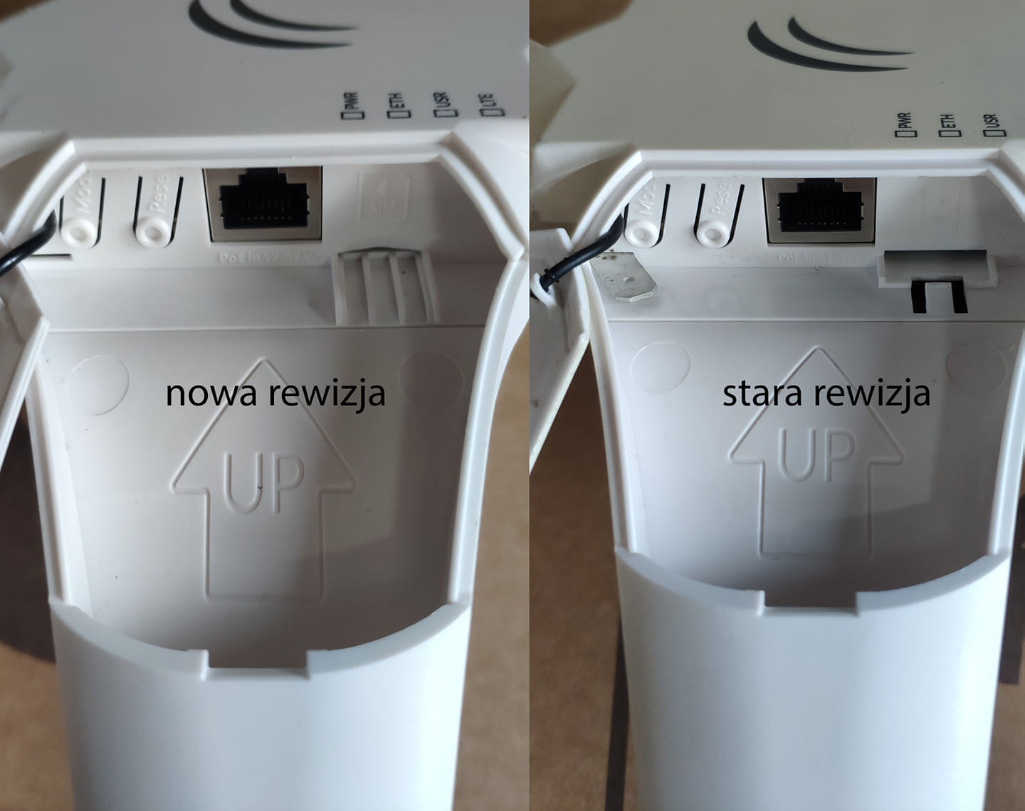

About LHGGR… he use a SIM slot of first Revision of LHGR who have solved that hardware problem in Revision 2 and slot is revert over 180° too !.
I not know why MikroTik create in new hardware like LHGGR the old know SIM slot with old know problem :(.
Yes, the office tape on back of SIM solve issue and HELP TO PULL OUT SIM CARD !!!.
