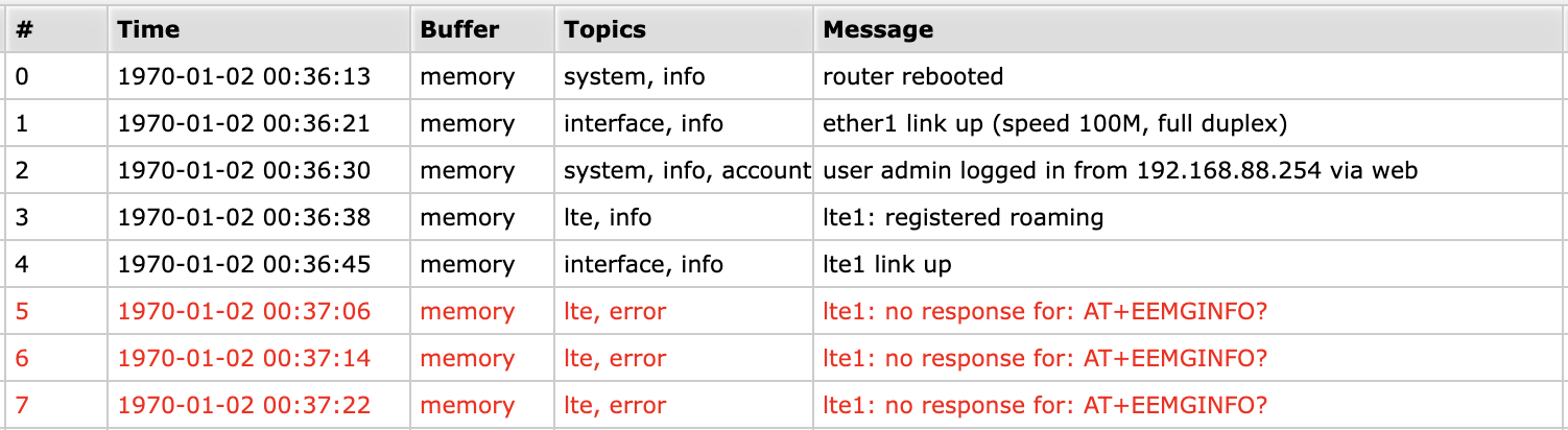

I still get the error message intermittently. I also get message “Ite1: no response for: AT+EEMGINFO?” in the logs:
On one occasion, for a few brief seconds, I saw data going to and from the mobile network. I clicked through to the LTE interfaces section of the web UI, and tried to download the latest LTE modem firmware. I got a popup saying that the firmware URL is unreachable. I went back to the cellular stats, it had disconnected, and then checked the logs to find the “Ite1: no response for: ATEO” message repeating.
