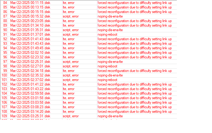

i have every night (but only during the night) lots of log messages “forced reconfiguration due to difficulty setting link up”

I think this has been introduced in RouterOS 7.17. Rolling back down to 7.16.2 - I was unable to get the error/message again unless I didn’t wait long enough.
RouterOS 7.17-7.12.2 - error says “forced reconfiguration due to long search time”
RouterOS 7.18 & above - error says “forced reconfiguration due to difficulty setting link up”
I’m seeing this on the older LHG LTE as well - probably applies to all MikroTik LTE devices. I’m only able to reproduce the error if I purposely choose a band that doesn’t exist in my area = no signal. This might be a debugging feature but it seems very unclear what it actually does when it says “forced reconfiguration” since all the lte settings remain the same - maybe it does something with the modem directly.
Checking the changelogs on 7.17 (unless I’m blind) but can’t find out where it mentions that change at all.
I have never seen those script errors before - are they yours or is that the watchdog feature? (I’ve never used it)

Yes it’s personal script

The message “forced reconfiguration due to difficulty setting link up” means that the lte interface was not in running state for 2 minutes (default value) so it is reconfigured (basically the same as disable/enable). You should look into the reason why the interface is not in running (R) state. If it is still unclear why it is reconfigured please create a support ticket.
