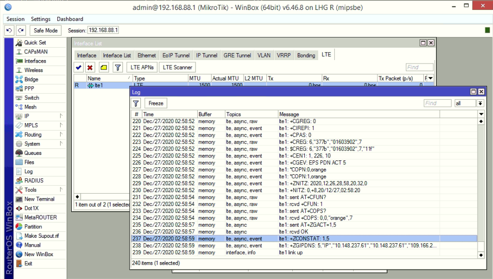

LHGR LTE6 kit - registered to network but ping = timeout
Dear All, i just got my directional antenna, I am using it in Romania, APN=net , there is no IMEI limitation. I use the antenna connected to a PC.
My problem is that is see the IP from the registered network, but i cannot ping 8.8.8.8 => ping timeout.
I use R11E-LTE6, modem firmaware is 026.
i have the IP/Firewall/Nat, set to out interface to lte1 and with masqarade
please help me to to have ping to 8.8.8.8 , i cannot make it wok
i did a this easy set up, from as indicated from: SiB
my info:
[admin@MikroTik] > /interface lte info LTE-4G once
pin-status: ok
registration-status: registered
functionality: full
manufacturer: "MikroTik"
model: "R11e-LTE6"
revision: R11e-LTE6_V026
current-operator: orange
lac: 14203
current-cellid: 23083266
enb-id: 90169
sector-id: 2
phy-cellid: 287
access-technology: Evolved 3G (LTE)
session-uptime: 2m7s
imei: xxxxxxxxx
imsi: xxxxxxxxx
uicc: xxxxxxxxx
primary-band: B3@20Mhz earfcn: 1600 phy-cellid: 287
rsrp: -109dBm
rsrq: -8.5dB
sinr: 8dB
Thanks!

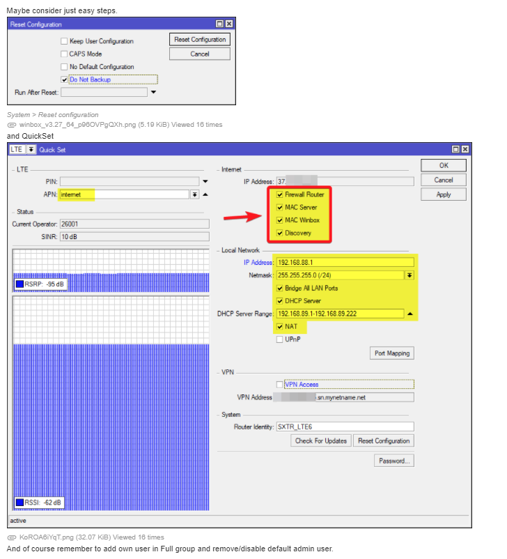

Gateway: 192.168.88.1/24
Your DHCP range is out of your declared LAN network.
192.168.89.1 - 192.168.89.222
Change 89’s for 88’s.
Regards.
