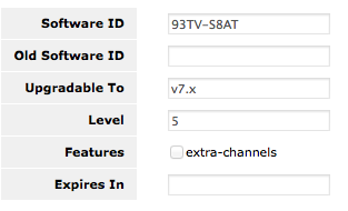

It looks like my customer has a licence that can go up to RouterOs 7.X
http://forum.mikrotik.com/download/file.php?mode=view&id=17206

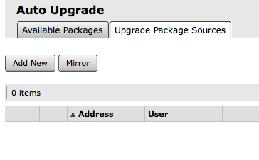

but i can’t get to upgrade the router to version 6.13 and i am stuck to version 5.2. It doesn’t find any packages.
http://forum.mikrotik.com/download/file.php?mode=view&id=17203
Also the mirror list is empty, that is maybe why…

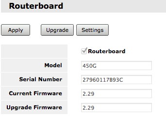

Here is the firmware version also…
http://forum.mikrotik.com/download/file.php?mode=view&id=17202

in normal you buy a RouterBoard and it comes with
an activated (licensed) RouterOS version on it as I see it right.
And in normal, you will be only able to upgrade the RouterOS version
to the next one likes from 5 to 6 or from 6 to 7, but often enough I have
seen RouterBoards often can do two steps so that means from 4 - 6 and 5 - 7
and this is nothing you can count on or it is a must be as I see it right now.
And so the question must be redirected to you and you should answer us more
the question from what you are trying to upgrade RouterOS and to witch version
you want to upgrade? So if your customer is able to get the vers. 7.x and he starts
with vers. 5.x all is normal looking for me.

go to system / routerboard and choose to upgrade firmware,

For the auto update feature to work a repository is needed which contains installable packages.
If you want to update your current installed version go to system → packages and click check update.

Auto upgrade can be used if one of your RouterOS machines will host the new package files, and other device can get them from there.
