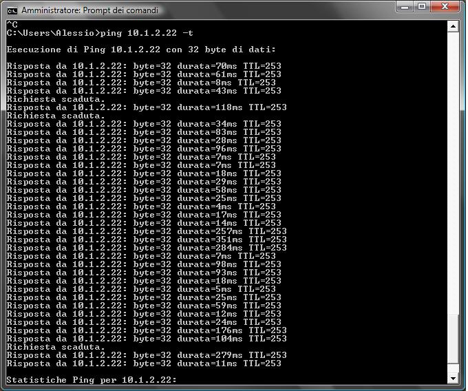

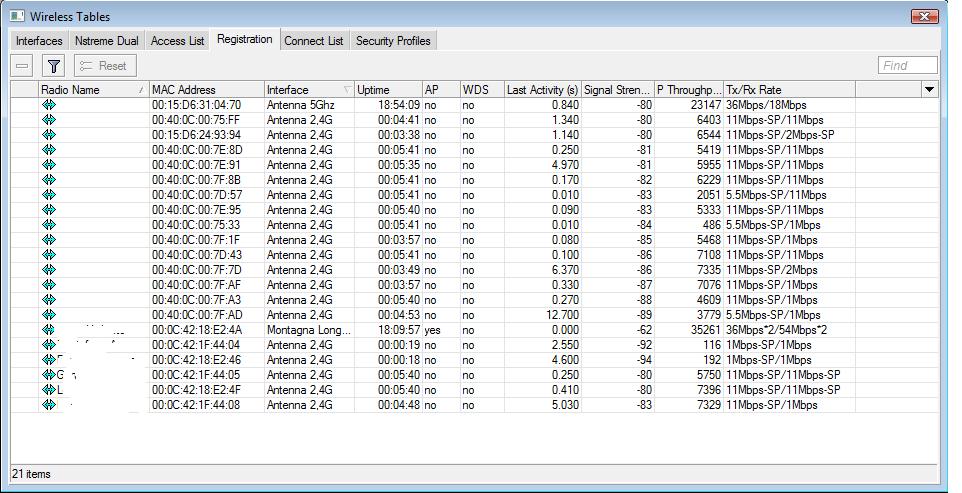

This is our situation at the moment
After the activation of the last 2 or 3 customers we get these stastistics:
even if the throughput of the customer involved is of 7Mb/s and there is no traffic made by it.

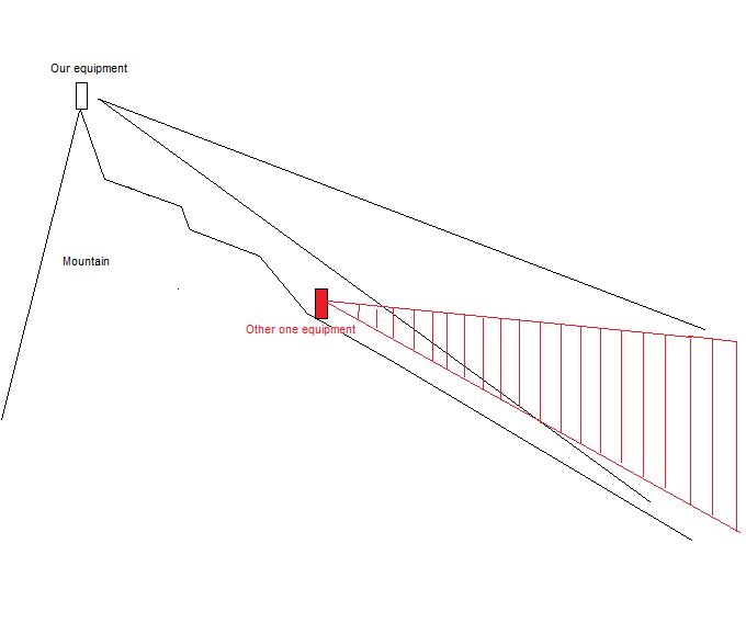

  2. there is an interference between our channel and another network which is using a channel adiacent to our one. This interference was not signalled by the antenna installed on mountain site, because of it isn’t on mountain. The interference was just 1 km. under the mountain in the direction of our signal.
    So on mountain we didn’t get anything, whether we get some indication about it on a series of customers all in the same direction of the mountain as indicated in the following picture:
    We spoke with the other equipments owners, they changed channel to a non interfering one and we solved the problem.
