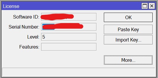

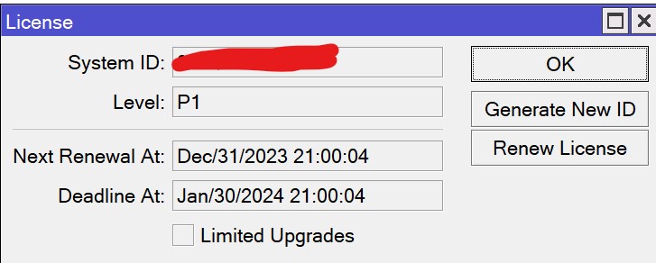

No, it doesn’t have to run. You can do it on the website, even if the old VM doesn’t run.
There are two different type of “device”
Physical Mikrotik device with embedded license:
Or CHR device:
I think if your system asks to add or update Key than you made something wrong. The CHR hasn’t Software ID and a Mikrotik device doesn’t have System ID!
