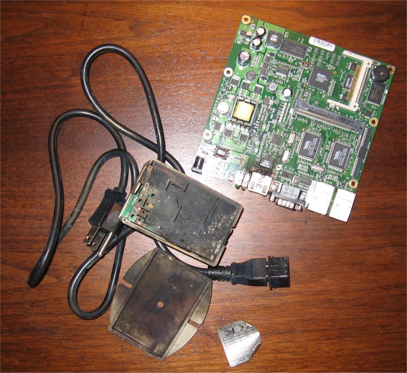

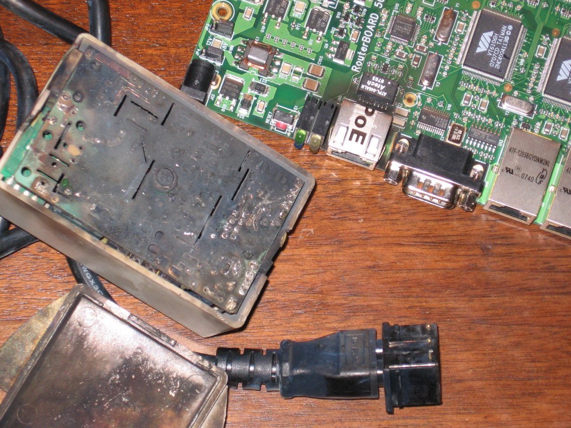

Here is a couple pictures of a PoE and 532a board used as an AP that got hit by an electrical surge due to a nasty thunder storm we had yesterday. 07/15/11

It was confirmed that an electrical transformer approx. 30 meters away was directly hit and this was the result.
The surge went through the electrical wiring and through the poe to the RB.
The radio card which was in use continues to work like a champ, while we had to replace the RB and POE.
