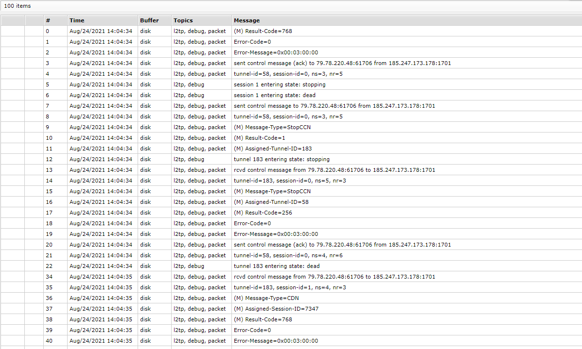

I have the same issue, only 5 users can connect.
The 6th users gets a message a connection could not be established to the PPP server
I have changed the mas sessions setting but it does not help.

see log
result code 256 and 768
I have fixed the issue. My vpn pool and had 10 addresses. I have increased this to 30, and more than 5 users can now connect
