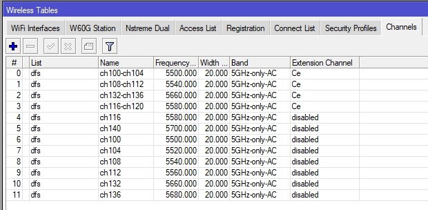

Enter the channels in the wireless interface setting
Something like this (my exemple is for a total different application … controlling channels on a SXTsq ac5)
And then use this list in the interface setting “Scan list”.

Too fast reply. Had a second look at your post.
I was afraid to see that there was Ce specified and I had to do that for each channel (define if its control or ext. channel etc.
for 20/40/80).

And tried to enter “numeric frequency ranges”
did not test it … but it looks like what you are looking for
