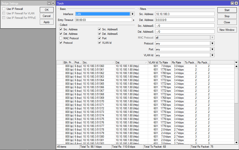

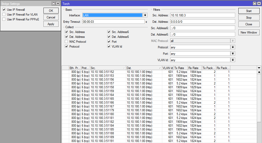

the gateway of the testing laptop is the 10.10.180.1 which also to get the login page as well…
but the issue is, when i turn on the ip-firewall-vpn, the routerboard will limited the http connection up to 6 to the gateway and become i not able to get the login page…
there is no ip firewall filter rule as i use it to make transparent bandwidth control, i just bridge 2 ethernet card only…
