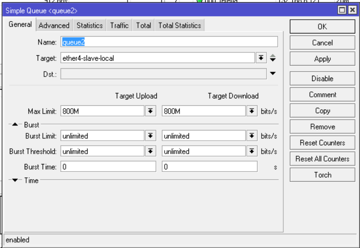

I was trying per IP queuing nothing and marking packets and connection, and traffic empty…

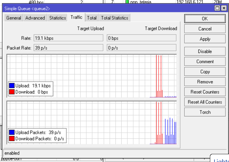

Queues only show when going to internet, as like the local traffic not even going through router.
I was trying to catch the traffic with the firewall rule to understand the src and dest, but was unable to do that.

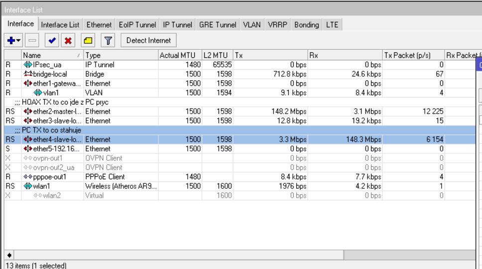

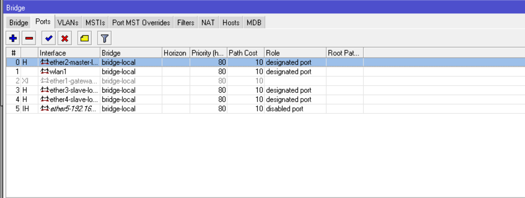

Basic reason why it doesn’t work for you is that traffic within same subnet is switched and not routed. In your particular case it’s handled by switch chip of RB951G as indicated by the ‘H’ flag on your first screenshot (it means HW-offloaded).
You might get things working, but you have to make sure all traffic between those two IP devices does flow through router’s upper layers and if you fail to do it properly performance of whole network may suffer. The easiest way of doing it would be to move one of those two hosts to another IP subnet (preferably the device with less communication with the rest of LAN devices), in this case all traffic to/from that device will flow through router’s upper layers.

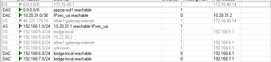

So i have done that a little bit different, i didnt want to change the whole interface subnet, so i created additional address with a seperate pool to 192.168.7.0.
The cpu is 100% and the traffic is 90MBit from previous 900MBit.
The question is, is it possible to put some firewall rule,masquarade,etc to make it fast as before?
I understand it is because of the rule procesing right? Or the additional step that is neccasary to comunicate? Or because i didn’t seperate the whole interface to subnet?
192.168.6.0 is my LAN
192.168.7.0 i made for this one IP that DHCP is giving by MAC
