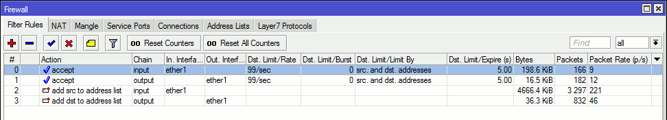

I have been trying to understand “limit” and “dst-limit”, and they were not working normally. After I found this post, now I understand. But I’m using 5.15 and apparently they are not yet fixed? Results below:
