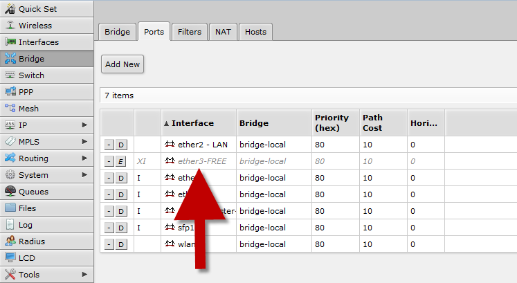

Thanks jacekes I have disabled the port like this:
From the eth2 port which is 192.168.1.0/24
ping the eth3 port ip address which is 192.168.20.254 → SUCCESS
ping a node inside the 192.168.20.0/24 which is 192.168.20.20 → FAILED
Problem still occurs…
