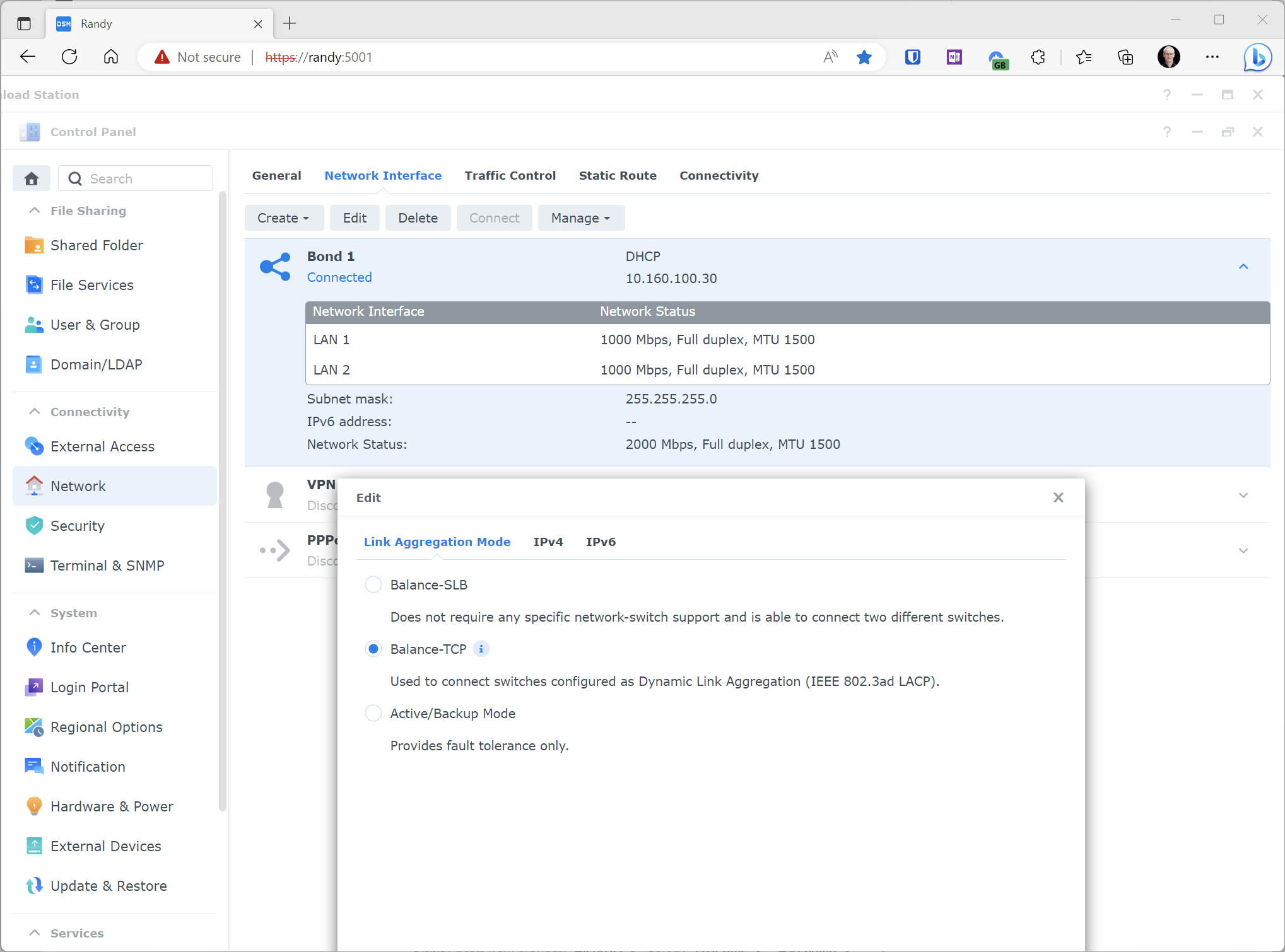

Here is the relevant info, as far as I can find. There are only a few things that can be configured in the Synology NAS. I’ve attached the MT config file.
confit3.rsc (6.61 KB)

Quick googling of what exactly bond type “Balance-TCP” does and how it works did not give me any informative results. So for me it’s still a black box. FWIW Synology may have created a Frankenstein supporting IEEE 802.3ad LACP (signaling protocol) and use balance-rr as algorithm to spread traffic between bond links. Or (continuing with speculations) it may be actual 802.3ad with transmit-hash-policy=layer3-and-layer4 … but having SMB server which selects source TCP ports for multichannel SMB so that resulting hashes will spread traffic over bond links evenly (which is only possible if bond is terminated on device running also SMB server which has information about actual state of bond … a “simple” switch can’t do that).
